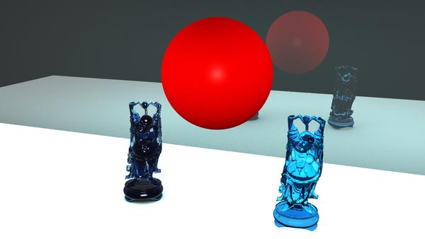

    I've rendered a test scene with 2x uberarea , 1 reflective plane, and 2 glass shaded objects (1 with Tofusan's on the left and one with DS default on the right) No problem with the glass but reflection and refraction is quite time consuming with 4 bounces.

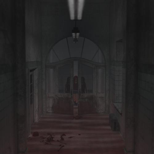

    Well, all in all this is the jist of the scene. Don't mind the opacity differences in the windows, I'm still working on this (looking for a good percentage so they're still see through, but so her reflections don't look like 2 other actual girls). Basically I'm just looking for a way to speed things up for some semi-decent quality preview renders. I know the final render is going to take a substantially longer amount of time. This version was also rendered through AoA's fog cam set to haze.
    Takeo, thank you for that explanation. Much appreciated. :)
