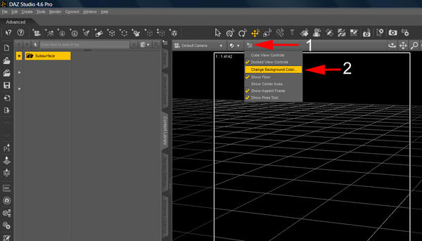

    Yes, simply set the background to black.
    I have a dumb question.
    How do I set the background to black?
    When I go to Edit > Backdrop it does not give me the option to change the colour. It asks for a bitmap instead.
    Am I missing something?

  • SzarkSzark Posts: 10,634
    hope that helps

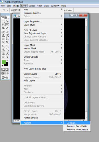

    In CS2 the Defringe is here
    653 x 938 - 304K
  • PendraiaPendraia Posts: 3,634
    Yeah...now that I'm more awake I remember there was an option in both programs. I used to use it to remove the black left from a background years ago. I haven't touched it in a long time.
  • Boingo the ClownBoingo the Clown Posts: 97
    Thanks Szark. :-)
    I was really getting tired of that powder blue background DS 4 starts off with. I was able to change the background colour in DS 1, 2, and 3, but couldn't figure it out in DS 4.
    I will trymmillighosts suggestion and see if it works.
