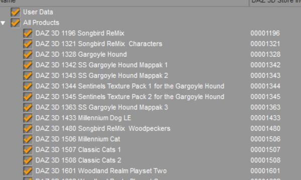

I'm not sure exactly where the issue is- but in the CDM my product numbers start at 1196, I thought I had a link to how to reset the (is this right?) Content Management Service? I assume that's what I need to do? I've checked the File, Edit, etc- am just overlooking it I think.
    Referring to: The Content Database Maintenance (like in the title) The menu in the upper corner where the tabs Surfaces/Smart Content is. (The section that has Reimport metadata)
    Will do screenshot (in a rush, company coming in an hour!)

    So basically, what do I need to do to get this running right so all my installed products that have gone poof get poofed back?

    Umm those are the item numbers from the store. It only means that your top item is the oldest you have from the store. Its not supposed to start at 00000001. Unless you bought product 1 that is. :bug: :cheese:

    Yep, I know- and what I'm saying is that some of my installed products aren't there- I have a whole bunch (sku numbers) ahead of the first one that is there- and they were all there two days ago, now suddenly I'm starting with this number.
