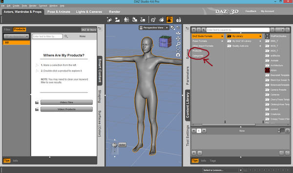

Hello DAZ team!
My name is Anderson Soares, known in the community Renderosity.com as Gendragon. My freebies are very well accepted and there has even been commented here! :-)
My reason for contact, is that recently, I was preparing a product for freebie in DAZ Studio 4.6 Pro, and tried to create support files in the "My Library", to facilitate the user after copying the content and can view it in "Smart Content Products". Moments after creating a script when you click the right mouse button on the icon of the freebie, seen in the "Content Library" -> Products.
There arose an option to create a script to support (DSA).
I created this script and then clicked on the run button, it was then that for some reason, after I closed the DAZ Studio 4.6 Pro and then immediately restarted, and to my surprise, everything that was in the "Smart Content Products", disappeared !
Today I can only see, something in the "Content Library".
Note: I've done all the procedures explained in the forum, since reinstalling the application and updates the shapes "morphs" evolution body, face, characters, V3, V4, A3, A4, H3, H4, F3, F4, S3, S4 , Axel etc..
From what I understand, the metadata is corrupted, and had not backed up at the moment. I am communicating this because I realized that other people are having the same problem, every time a new product is launched into the application, especially the older ones, it is obvious, will not appear in Smart Content Products, because they were made before the creation of "Smart Contents".
I'm hoping for a new update for this because I'm used to the "Smart Contents" to locate more quickly to my library.
Cheers and thank you for making the DAZ Studio free software.
Sorry my Inglês! :-)
Anderson Soares - Gendragon
My gallery: http://www.renderosity.com/mod/gallery/member.php?my_gallery
1438 x 859 - 183K
Post edited by Gendragon3D on
    The problem that you have, appears to be that the CMS (Content Management Service) is not running, I can see that by the lack of little triangles opposite the names Products and Categories (unlike DAZ Studio Formats and Poser Formats)
    CMS runs as a process in Windows, and should appear in the Processes tab in the Task Manager. If it is not running, you need to go to Start > All Programs > DAZ 3D and start it from there.
    CMS runs the Smart Content pane, Products, Categories and the search function in the Content Library pane, so it needs to be a running process. See if that helps.

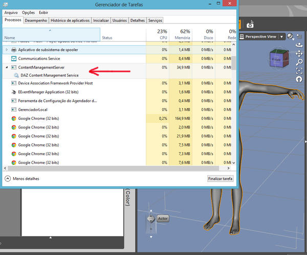

    Mike made I bit of a typo in his last post. DIM is ONLY 32 bit, there is no 64 bit version, because there doesn't need to be, 32 bits is more than enough for it to function correctly on both 32 bit and 64 bit Operating Systems.
    DIM should work on any 64 bit system, I use it almost on a daily basis on Win 7 with no problems at all. If Support helped you with a download which did not have the correct files in the folder, that is a different matter. I have nearly 2,000 items downloaded and installed with DIM, and I have had very few problems.
    My problem is I can’t get any of my Content to show up in the Smart Content tab even through I can find them in the DAZ Library Folders. I was told to uninstall the CMS and reinstall it through reinstalling DAZ Studio 4.6. If it doesn’t work, I needed to add all my content again
    You do NOT need to add your content again, just the Metadata, leave the content where it is. If you cannot get CMS to run, then Smart Content will not work at all.
    You have tried to start CMS from the Start menu, and it does not start? Have you checked in the Task Manager for Windows to see if it is running?
    If you have tried all of the above, the only thing I can think of, is that the database files have become corrupted, and they would need to be redone. As I already explained, if you do not have any Categories that you have set up your self, or any other customisation of the data, then you can just replace these files. There is absolutely no need to redownload and install content, it will be fine where it is.
    If you could go to the Content Directory Manager, and post a screenshot of the expanded listings for both DAZ Studio Formats and Poser Formats, that may be a help. Can you also post a screenshot of your interface showing the Content Library pane too please?

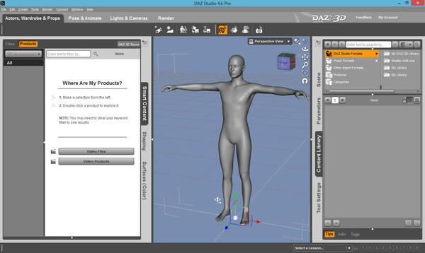

  • SzarkSzark Posts: 10,634
    gedonia Jimmy asked for a screenshot of the Content Library Pane (Not Smart Content or Metadata)
    If you don't have a Content library Pane open then you can open it Via the top menu Window > Panes (Tabs) > Content Library
  • Gendragon3DGendragon3D Posts: 177
    Sorry!
    Please see if it is!
    Thank you!
    1439 x 852 - 239K
    edited July 2013
    To the best of my knowledge, the CMS is part of the main install of DAZ Studio (any version 4.x), but if it already exists, it wont be replaced by the latest version. In order to install the latest version of CMS, it is necessary to uninstall CMS first from the Start menu, then re-install DAZ Studio.
    There could also be problems with a corrupt database which is preventing CMS from working properly. The only cure that I know for that, is to move (or delete) the current database files, then restart DAZ Studio which will recreate them. You then need to reimport all of your Metadata files as well. This is simple enough if you don't have any Categories or Products that you created yourself, because they will not be redone.
    You would need to have a saved version of your own Categories, and reload that in the same way as the Metadata files. I had to do it with mine a few weeks ago, but it worked well, and I haven't had any problems since.
    Excuse me, but how and where do I find these metadata to delete them?
    By chance is the "data" directory, which is inside the "My Library"?
    I've reinstalled DAZ Studio, ContentManagementServer after uninstalling them.
    In the "Task Manager" windows is showing the functioning of "DAZ Content Management Service", but still not loading the products, re-import the metadata.
    Regards!
    Anderson
