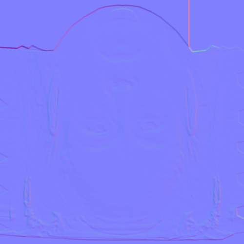

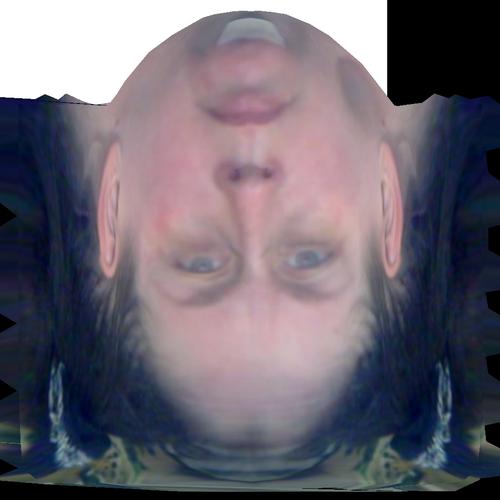

  • WendyLuvsCatzWendyLuvsCatz Posts: 41,573
    edited July 2013
    there is an android app
    Normal Map Generator
    its free
    1024 x 1024 - 401K
    1024 x 1024 - 349K

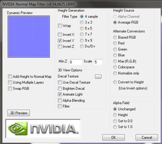

  • RiffulRifful Posts: 0
    edited July 2013
    I found a free Normal Map plug-in for Photoshop once at Nvidia. It had too many settings I didnt understand, so I put off trying to figure it out for a bit, but it would be nice to be able to make Normal Maps for various textures. Here's a screen of the settings:
    https://developer.nvidia.com/nvidia-texture-tools-adobe-photoshop
    532 x 475 - 28K

  • frank0314frank0314 Posts: 15,103
    edited July 2013
    Here are the setting I normally use. What you need to really pay attention to is the Height Generation column. There are a few good tutorials on youtube
    527 x 470 - 54K

  • cwichuracwichura Posts: 1,042
    I've read that the Nvidia plugin tends to generate 'noisy' normal maps, such that you get artifacts when rendering. Have you had any problems with that?
    Not that I've noticed.
