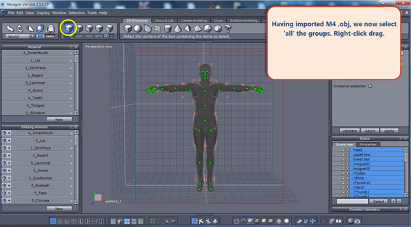

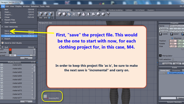

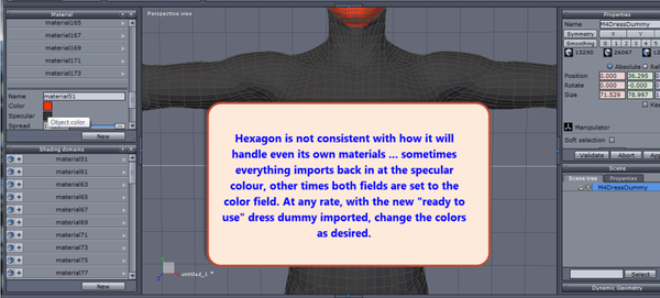

Make a "dress dummy" of M4 and V4. Use a COPY of the main .obj file that is loaded when said figures are loaded into D/S. You'll find them in the Geometry folders. Unlike the "dress dummy" for Genesis, for this one you do want each body part to have its own colour.
Hexagon seems rather quirky about whether or not it'll keep or display materials so not to lose any sleep over the matter if one has to repeat the procedures every now and then.
Post edited by patience55 on

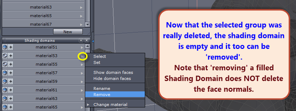

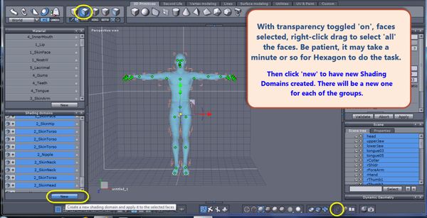

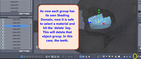

    First set of images ... for making a "dress dummy" or "mannikin" with which to model on in Hexagon or whichever modeling program you're using. I use Hexagon ....
    945 x 441 - 62K
    900 x 523 - 189K
    955 x 481 - 67K
    1000 x 512 - 237K
    900 x 497 - 189K
    Continuing ...

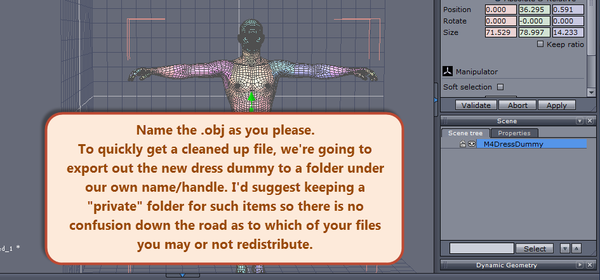

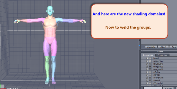

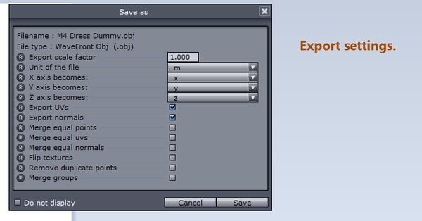

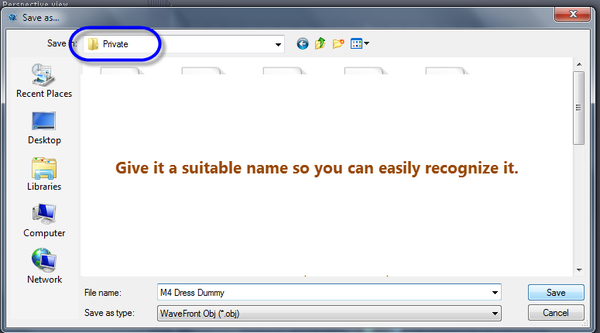

    After image 10, when the Dress Dummy is 'all fixed and ready to be', export out the new Dress Dummy .obj file letting it to overwrite the first dress dummy that was made.
    830 x 311 - 60K
    1080 x 450 - 183K
    632 x 358 - 18K
    673 x 352 - 18K
    775 x 430 - 52K

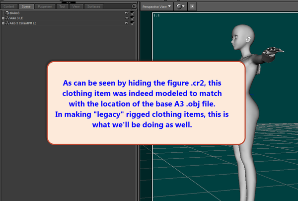

    Legacy rigging for the older characters and/or other characters found in the wilds can be rather, challenging.

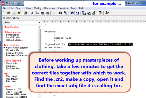

    First, one does need to ascertain 'which' .obj the figure's .cr2 is calling for. A copy of that .obj is what one would make into a "clothing dummy" as illustrated above.
    While 'blanks' may or not appear to be available to rig clothing for the older figures, they often still require some "tlc" [tender loving care] before a redistributable file is indeed had. We do NOT include "ik" information and NO morphs. A blank is "just" the bones of the figure required by the clothing.
    There is a nice video tutorial "click here" for making one's own blank .cr2 file. Note that after knocking off the ik chains, "save the new blank .cr2" [start with a COPY of the original] ... and then open that with the morph editor utility [available here] and then save the file yet again.
    The new blank file I ended up with had a pmd file to match it and a couple of references for it. I deleted both the pmd file and references, resaving yet again the blank ... and hopefully it's now usable for rigging redistributable clothing.

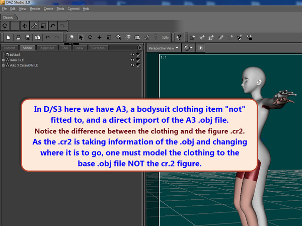

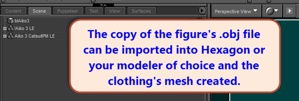

    Here are a few images that hopefully clarify the point of 'why' we model to 'what'.
    704 x 239 - 22K
    1057 x 712 - 68K
    1026 x 768 - 115K
    728 x 491 - 46K

    Yes the skirt needs to be made first. This was just a basic A-line short skirt. High enough on the hip to have some face normals on the abdomen but stay beneath the 'chest' parts. And above the "thigh" shading domains.
    Once made, "group" it ... need two groups, "abdomen" and "hip".
    Needs to be saved or put into "your" geometry folder in Geometries under Runtime which is under My Library.
    Eventually the saved .cr2 is exported out to "your" folder in the Character folder in the same Runtime.
    In previous tutorials [either in this thread or over at DA] illustrate making a clothing model so the various groups are easy to see.
    Also there's information on making a blank which is the one I'm using in this tutorial.
    We may copy of the rigging from A3, but NOT the morphs etc, into clothing items.
    Morphs must be those we've created ourselves. [although for some figures I recall seeing merchant resource utilities offered before the days of weight mapping and triax.]
    .cr2 files are exported from D/S to save them into usable files.
    They are not sent to Hexagon.
    When one selects the .cr2 skirt and Bridges it over to Hexagon, D/S sends over an .obj file.
    That .obj file is morphed and then returned to D/S over the bridge so the dialogue will happen to create the morph.
