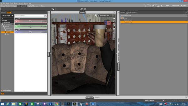

    I can't find the relevant bit in DS 4.8, and the orange/yellow is driving me mad......
    Help, please!
    1920 x 1080 - 435K
  • ben98120000ben98120000 Posts: 469
    Window - Panes (Tabs) - Draw Settings. Under General menu - Draw Style.
  • MJWMJW Posts: 540
    Absolutely FAB! Many thanks. I wonder why people can't simply continue to use the same methods.......
