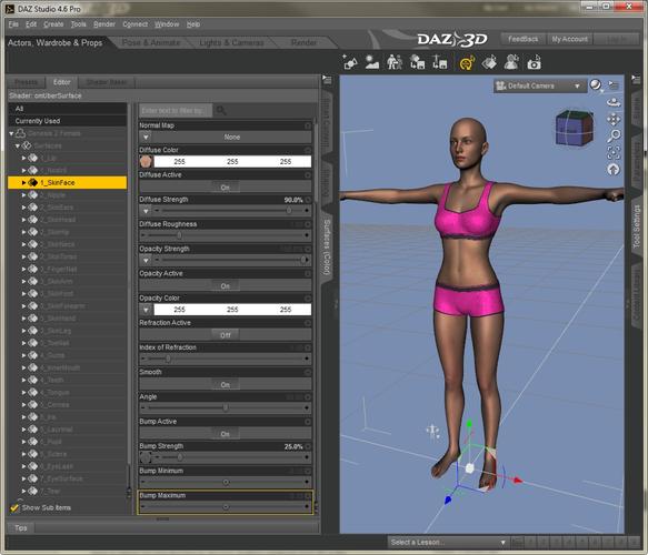

A Daz Studio script that changes the surfaces from G2F to the surfaces from Genesis1.
This allows you to save material presets from G2F and apply them to G1 (provided you have matching UV-sets for them). It might also be helpful for folks that export G2F into external apps and preferred the G1 numbered surfaces, but i haven't tested this.
With G2F selected, run the script. The surfaces will change (you may need to select something else first and reselect G2F to see the changes in the surfaces tab).
http://www.sharecg.com/v/70109/view/8/Script/Genesis1-surfaces-for-Genesis-2-Female-DS-script

UPDATE : fixed typo's in the surfacenames 3_Fingernail, 3_Toenail and 6_Eyelash. Added a script to change G1 surfaces to G2F, now both G1 and G2F can switch back and forth between G1/G2 surfaces.
Big thank you to CauriB for providing the G1 to G2F script !

    Yes, the script only changes the names of the surfaces in DS. V4 for GF2 provides the V4 UV-template for G2F.
    A V4 skin made for Genesis is still a V4 skin that uses the V4 UV-set.

    Only textures with a UV-map that is shared by both G1 and G2F can be exchanged.
    The script was written for the following scenario : you have a scene where G2F/V6 has a V5 texture apllied, and you spend all the time to make the texture come out real good and now you want to save this as a material preset for future use. Because G2F has different surface names than G1, you couldn't apply this material preset to G1 although it's a V5 texture. The script renames the surfaces, you save the material preset, and now your V5 material preset can be applied to both G1 and G2F/V6.
    If you have MallenLane's 'V4 for G2F', you can also use the script to apply pz2 and ds(a) V4 textures to G2F without having to convert to *.duf (but like said before, the ears will be ignored, copy the settings from the head in the surfaces tab).
    Turned out that the script was also usefull for folks who export G2F/V6 to external apps, like Reality, who were used to the numbered surfaces and now with G2F/V6 got an alphabetical list (where teh groups are scattered all over the place).
