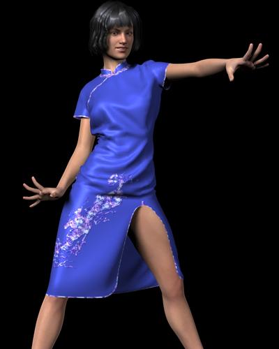

I thought I'd do a quick render of my newly acquired Fast Grab Dynamic Qi Pao Dress together with Genesis 2 Female, using an official Genesis 2 Female Pose (Pose #18). The dress looks nice, but ... what on earth is going on with the fingers?
Now I know that cross-generation poses are often likely to give these sorts of results, but I did not expect it of poses specifically designed for a figure. Some of the other poses give dubious finger contortions also. Ironically the pose looks better on Genesis 1.

    No, the "mistake" is straight out of the box. You can test it yourself in about 5 seconds:
    a) Load Genesis 2 Female;
    b) Apply Pose #18.
    Naturally, it can be corrected. My basic concern is one of quality control. Is this supposed to be a bona fide Genesis 2 pose, or is it an old Genesis pose which has mistakenly slipped through?

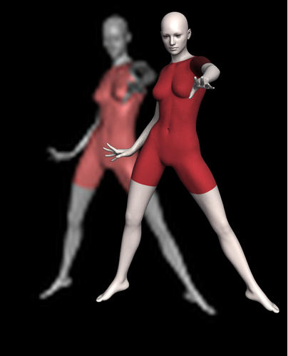

    Maybe the pose is what it is. The blurry picture is the blown up icon .png for pose 18.

    Yes, it looks like you're right. The default Bend limit for Index 3 is -10, the pose has -23.68. The Bend limit for Index 2 is -12, the pose has -20. These are specified in the .duf file.
    So my picture is the pose with the rotation limits off. The picture you posted has them on. I have changed my default setting in Preferences to "limits on" (I can't even remember turning them off) and it now loads "correctly". But it seems bizarre to me that the pose was even created with them off.
    Minor enlightenment!

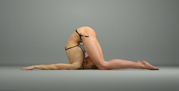

    Never occurred to me the culprit was having limits turned off. Like most, the default is limits turned on. But I recently had to turn limits off to use Smay's Yoga pose set for Genesis that I picked up during the last flash sale. Again, there was issues with the hands on Gen2, but setting the left and right hand "Fingers Straightened" pose to -1 worked perfectly.

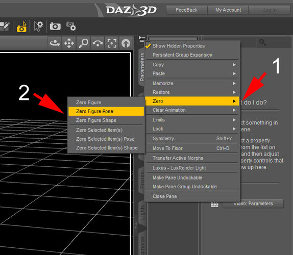

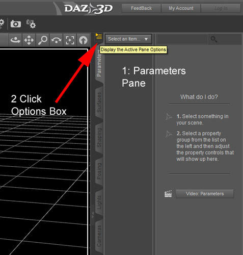

    Two quick questions- how to zero a pose? For Genesis, in Smart Content, they have that figure under poses to click on, but what's the faster way? Second, where is the Preferences to set the limits to On?
    Zero Pose > Parameters pane Option Box
    Also in the same Menu you have "Memorise" there you can memorise Pose and Shape.
