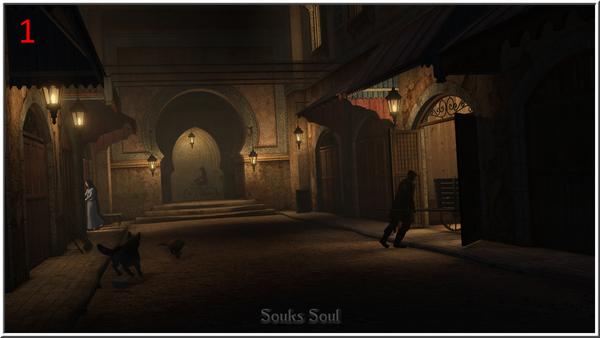

    With image one below I used Linear Point lights only to light the scene using a volumetric camera from Atmospheric Effects Cameras for DAZ Studio. It took some tweaking the camera and light settings but I hope you agree it was worth the effort.
    Side Note: What is a volumetric camera think air, it has volume, dust particles, smoke, fog (water particles) etc we just don’t see it often. This camera mimics this which can give the illusion of a volumetric world. Example of this is when you see light beams through a window. The light highlights the participles in the air; a smoke filled room is the best example of this. Another is what is termed in some CG circles as God Rays, lights beams poking through a gap in a dark dense cloud bank. But this is just one aspect of this camera set; it can simulate daytime Haze, simple uniform Fog and a few other goodies.
    Point lights are also good for faking light bounce or fill lights to lighten up the shadows (without shadows turned on you can use the point lights as ambient light), candle or fire lights or combine them with spot lights for light fixtures as shown below in image two.
    In image 2 I used one normal Daz Studio Point Light and two Daz Studio Spot lights per light bulb. Yes that was six point lights and 12 spot lights for the ceiling and the back wall light fixtures. One point light for the fire and one distant light coming through the door. I also had a further 8 distant lights at a very low intensity, I think about 1.5% with no shadows positioned as though they were in each corner of the room aiming at the centre of the room, the 3D centre and not the floor centre. Why so many lights, it was an exercise. :)
    For the light fixtures the point light was placed close to the upper tip of the light bulb itself. One spot pointing to the ceiling above the point light and the other spot light under the light fixture pointing down at the floor in line with the top spot and point light. Just remember most Graphics Cards (OpenGL) will show the effect, in the viewport window, for seven lights that you add, yes eight is the limit but with the preview light that makes eight. ;)

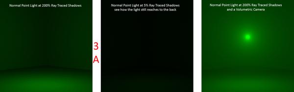

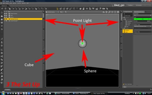

    The Example Scene below is made up of a Cube, one Sphere and both a Point and Linear Point Light at the centre of the sphere. Excuse the quality as with my system it takes a while to render anything, then add a volume camera, yep it has taken a while to get all these rendered which is why I chose medium quality to render. The camera was placed inside the cube to make a closed environment for the volume camera to work properly. Both Point lights were set to 200% intensity with Ray Traced Shadows. See image 3: The Set Up.
    Image 3A is simply a normal Daz Studio Point Light with the sphere hidden. Take note of the hot spot in the volumetric render, the Linear Point doesn’t seem to produce this hot spot at the same intensity levels. This is shown further down the tutorial.

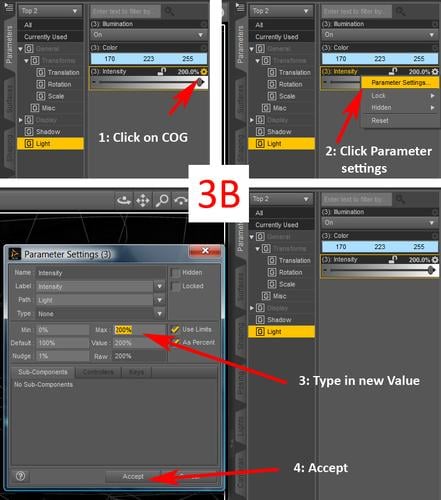

    TIP: Most lights have a limit of how high you can set the intensity, the Point lights have a limit of 200%. This limit can be adjusted as shown in the image 3B below. This changing positive and negative limits can come in handy for all types of things in Daz Studio, great when you need a really long neck etc. ;)

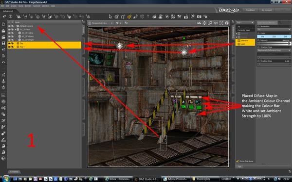

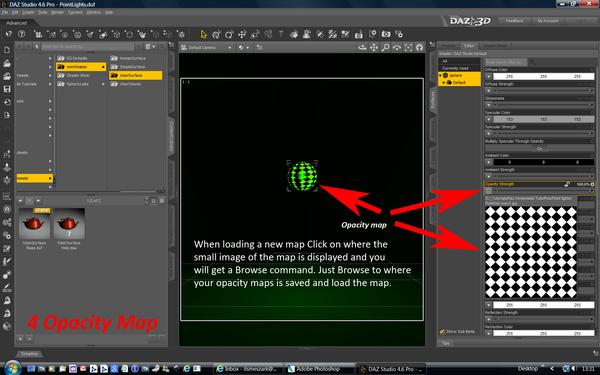

    Fake Light Gels: Let us have some fun with placing Point lights inside primitives/objects, in this case a Sphere and then apply an opacity map to the sphere. Where the map is black parts of the Sphere will be transparent and white will show solid as shown below. So the light will pass though the sphere where it is black which is governed by the opacity map. Consider this a fake Light Gel. Again Uber Points and Spots have a Gel function built in which means you place this Opacity Map or Colour map in to the colour channel of the Uber light.
    Images 4 and 5 will show what an Opacity map looks like and how to load it in Daz Studio via the Surfaces Pane whilst the sphere is selected. The Opacity map was made in Photoshop with the shape tool, scaling and duplicating the shape to make an array and saved as a .jpeg. Feel free to save the example, crop it square and have a little fun.
    The images in 5A are the results of using the above Fake Gel, then getting a little more creative hiding the Sphere using Uber Surface’s Fathom function (see the next post down for how to do this) and then finally adding a volumetric camera in to the mix.

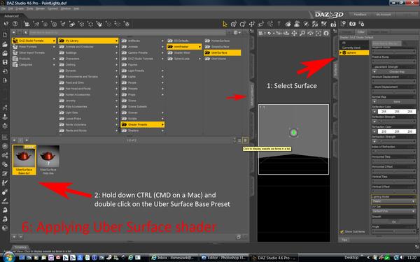

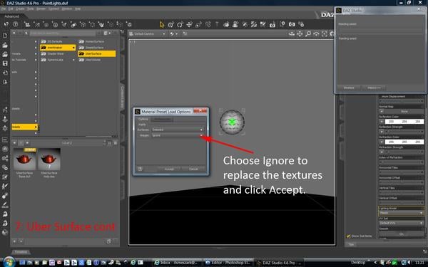

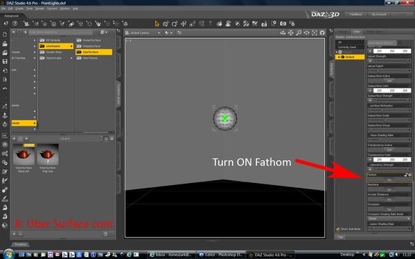

    In images 6, 7 and 8 shows how to use Uber Surface and the Fathom function to hide an object from the renderer but still let the object cast a shadow in the render. This Fathom can be used for a number of effects and techniques. That is half the fun thinking how to use cool functions like that.

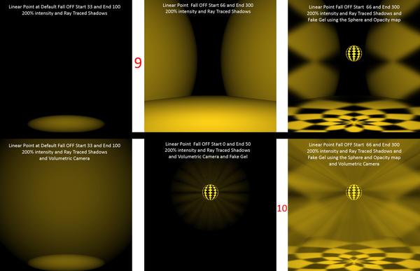

    Linear Points Light examples: Same scene as above but this time using the Linear Point light instead.
    Image 9: As labelled the first example is at the default Fall Off settings as it loads in to Daz Studio. I increased the intensity to 200%, changed the colour and turned on Ray Traced Shadows. As you can see it just manages to hit the floor. The second I increased both the Fall Off values with more light spread. The third, like the second example but using the fake light gel sphere, funky stuff happening now.
    Image 10: All these examples use the volume camera and combine that with the control of linear point lights we have you can do some cool stuff.

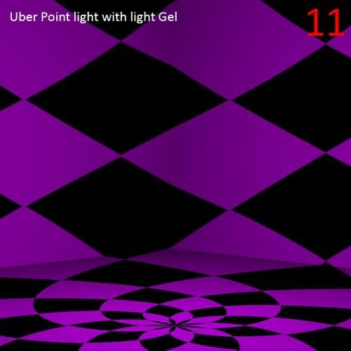

    Image 11 is an Uber Point Light, Intensity 200%, Fall Off Start 0, End 500 with the Sphere’s Opacity Map placed in the Colour channel of the Point Light and set the colour bar to purple and rendered through the Default camera.

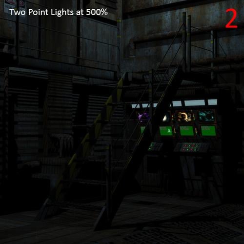

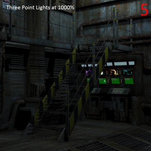

    Point lights are also good for making some cool shadows, especially when using well designed props, point lights really come in to their own.. Here I have a corner of the Loading Dock by Art Collaborations and some normal point lights. With this scene you don’t see the source of light so it really doesn’t matter where you put them. The only source of light in the part we do see are the screens and light strip that I made a blue colour. We could turn that strip in to an Area Light to add more light detail which I did in the next post. See my Uber Area Light Tutorial.
    The first render in this series of images has two point lights as the base lighting at 500% intensity with Ray Traced Shadows, shadow Bias set to 0.10.

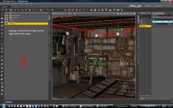

    The second render I added another point light, same settings as the other two, to lighten the right side of the image.
    The third render I just raised the intensity more.

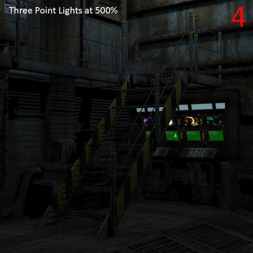

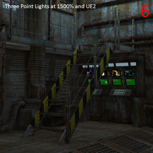

    Just to show how point lights can work well with other types of lighting I started to mix it up a little.
    For the forth render I increased all three point lights to 1500% and added the Uber Environment 2 light at 20% Intensity set to Occlusion with Soft Shadows using the Soft Box HDRI Preset at 50% Saturation and at the 3HI Quality setting. Building up the lighting like this, rendering each time you add a light, can help get your lighting right.
    The final image I deleted the Uber Environment 2 light and added the Uber Area Light base to the blue light strip above the monitors (screens) and set the Fall Off Start at 0 with the End set to 200.00 (2 meters) at 300% light intensity coloured the same as the ambient colour. I also dropped the Point light intensity down to 500% to create more mood.
    Hopefully you can see point lights can be a valuable asset in your lighting arsenal as a base or as your main and only lighting solution
