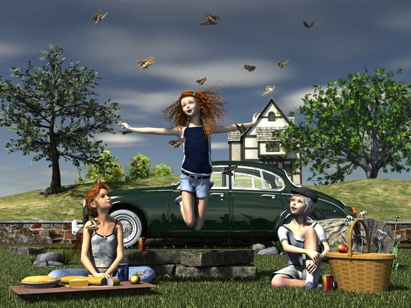

..been working on a pic that with a couple trees and Noggin's Ultimate Butterfly. The scene is lit with Cloud9 which uses UE. During test renders I notice there is a fringe effect around the leaves of the trees (one of LB's Oaks, and a tree from the DM Garden Collection) and the butterflies, that makes them look like a bad job of layer pasting. I'm hoping this is not another case of older content not being totally compatible with the latest release of the Studio app.

  • kyoto kidkyoto kid Posts: 42,399
    ...OK here is the test.
    The effect is mostly noticeable on the top of the butterfly wings as well as the top of leaves on the tree to the left.
    I spent a good part of the morning/early afternoon trying everything I could think of from adjusting the specularity and translucency to turning off raytracing on the wings and leaves and nothing worked.
    800 x 600 - 417K
  • SzarkSzark Posts: 10,634
    I can just make out the issue Kyoto with these old eyes. This is wierd as I had a look at the OAK transmaps and they look ok to me, nice sharpish edges. Don't have the flutterbys.

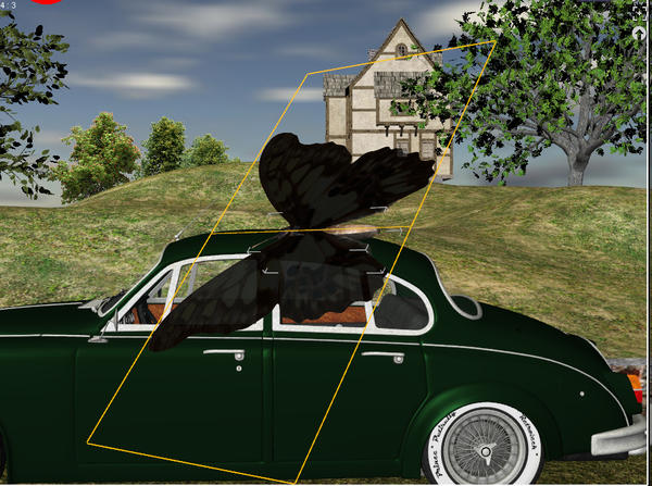

    ...here's a closeup of one of the butterflies and yes it appears there is a one pixel fringe about the wings which when rendered at a distance becomes very noticeable even setting the pixel filter to 1. Unfortunately that is the lowest limit as setting to decimal values redults in a 3Delight warning message that it is an invalid value.
    I applied Ubersurface to experiment with more settings and when I lowered the strength of the Diffuse channel on the butterfly wings the fringing disappears, however it also darkens the colour and thus washes out details of the wings.
    Attached is a render of the closeup and screen shot of the transmap

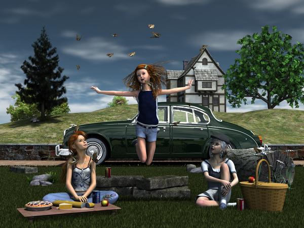

    Installed the new DL of the Ultimate Butterfly Collection (noticed the splash screen was the new one) and reloaded the swarm around Annika (the girl jumping in the air). Unfortunately, the fringe was still there even at a render size of 900 x 1200. Figured I'd tackle with that in the morning. However looking at the test just before I closed it, I noticed there was a bit of graininess to her, Leela and Tracey, so I checked the render settings and discovered the Shading rate had defaulted back to 1.0. Adjusted it to .2 and ramped up the sample rate for the main UE light to 256, set it to render again and suddenly the fringing around the wings disappeared.
    the Render is still cooking 46% at 1hr 36 min (rendering with a bucket size of 8) though just got through with the trees so it's moving better again (until it hits the transmaps for Leela's hair). Will try to post the latest test tomorrow as my connectivity is giving me some fits tonight. Still have a few things I need to work on (like adding SSS to the skin and a few items off screen behind the camera to reflect in the car).

    ...here is the latest test.

    I think this is a fantastic render! It is so alive and joyful and full of delightful detail.

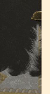

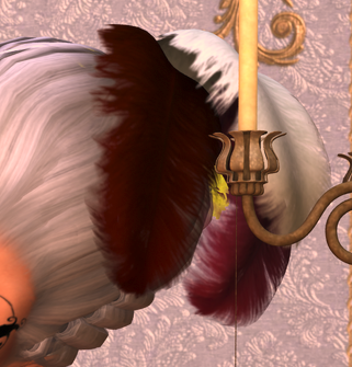

    I have the same fringing problem. It seems to be associated with delicate transmaps around the edges. I rendered the same image in lux with out the fringing. Maybe we need to clean up the old transparency maps?
    In order
    - The shadow from Lux
    - DAZ studio 4.6 feather
    - Marie Louise feather in Lux
    Something is wrong with the edges.
    edited June 2013
    ...as I do not use Lux (yet - still need to finish the Reality tuts) I'm not sure there.
    With 3Delight I dropped the shading rate to .2 and ramped up the sampling rate as well as enlarged the render size. All of these together basically eliminated the effect around the wings.
    The unique issue with Ultimate Butterfly is that there are different wing shapes in the MAT poses so two large transparency maps are used, one for each of the wings. This is similar to how the MFD works, swapping areas of transparency and texture which allows for a multitude of different dress styles from one basic mesh. The transparency zones are included as part of the actual MAT/texture file.
    See the screen shot of the single butterfly on the previous page and notice the rectangular outline of the full transmap plane area around each of the wings. If I were to use a volumetric camera or effect, there would be a visible rectangle around each wing.
