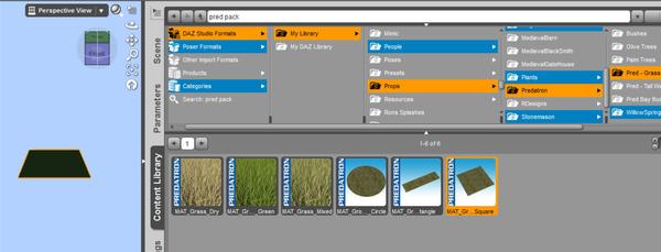

Go up to the upper left and click on Create > New Primitive>and select Plane. Photo 1 and 2. Change the plane to a smaller size, you can experiment- mine is set at 100 x 100 and I dropped it down to 40 x 40 (not shown)

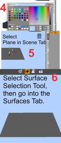

Now before we color the plane, let's do a light blue background color for the sky. Skip this paragraph if you want to continue with the plane, you'll skip photo 3/4, go to photo 5.) Go to Viewport Options, which is at the upper right corner of the viewport (photo 3) Click and select "Change Background Color." (Go to next set of photos. ) Photo 4: Pick a blue or bluish gray. I go subtle at first.
Select the plane in the Scene tab. (Photo 5)
Photo 6: You will go to the top of the viewport and select the Surface Selection Tool. It looks like three black sheets of paper. Open the Surfaces Tab (if you are in the original setup, it will be on your left.)
Next set of photos:
Photo 7 Be sure you are in EDITOR in the Surfaces Tab. If your plane isn't selected, all you have to do is click on it. (All/Currently Used/Plane is in gold.) We'll change the diffuse color (your "base" color.) Click on the black arrowhead (to the right of the last 255)
and it will open a color chart. (Photo 8) By moving your mouse around where the + is, you change the color. And if you move that vertical slider (the up and down one to the right) you can make your color lighter or darker.) I went with dark green.
Photo 9 Then click OK and your color is applied to your plane surface.
1102 x 1464 - 335K

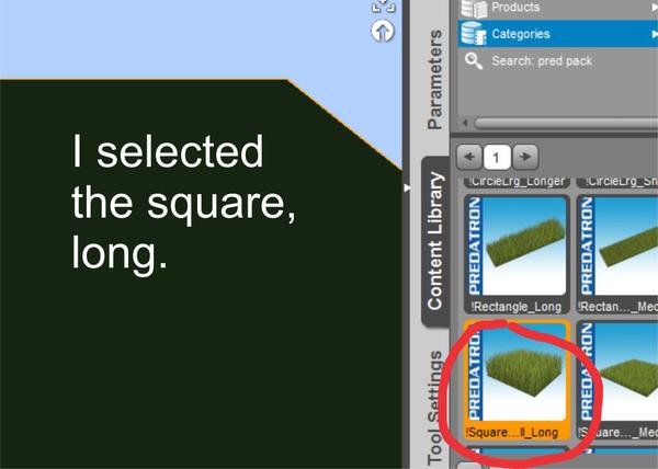

  • NovicaNovica Posts: 23,923
    Next set of images.
    556 x 1297 - 213K
    Last set. I had to break up the images as they were put side by side and were screwy.
    1285 x 1860 - 509K

    Here is where you will find your Pred Grass One after you load it. ENLARGE THE PHOTO BY CLICKING ON IT. There is a thread on which files you need, and screenshots (which initiated this thread) so surf in here to see what files to download: http://www.daz3d.com/forums/discussion/18771/#330345
    Let me elaborate:- although the Grass One has bases for the grass, you need to "load it onto an object" so you need a plane. That is what we just created.
    Here is where you will find the BASE.
    SIDE NOTE: Remember, if your main file is a DIM with a second DIM file a STUDIO CF (companion file) that means the first DIM is POSER. So your main thing-a-ma-jiggy will be in the Poser Library if using Smart Content tab. I have a video tutorial about DIM files- if you have a STUDIO CF, the first DIM is Poser file. If you have a POSER CF, the first file is a DAZ Studio file. They are always going to be opposites.
    Since this has a STUDIO CF, I need to go to the Poser Library to grab my base. (thanks fixmypcmike- I did miss that the P3DA was this vendor and not spelled out!)
    1010 x 720 - 166K
    1978 x 1104 - 264K
    Post edited by Novica on

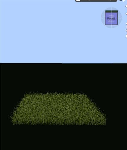

    So to summarize, you create a plane, use the Surfaces tab to change the color of the plane (optional, if covered with grass you wouldn't need to) then load up your grass. Below is the screenshot for where the materials are located. (I didn't use them.)
    Next post for the final result.
    1846 x 705 - 145K

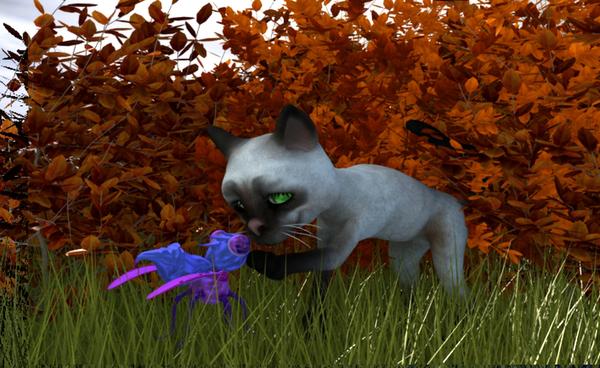

    And here's your grass. :)
    1039 x 1230 - 79K

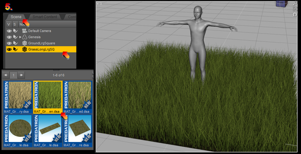

  • JaderailJaderail Posts: 0
    edited May 2013

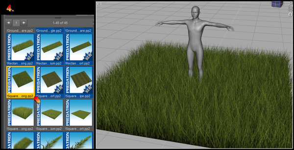

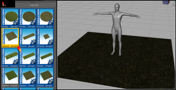

    Pretty good... I had to jump in. After I did this I noticed that like you the Mat file for the Ground planes does not load to any Prop. I was going to show how to Tile it for bigger ground Planes. I will report the error to Daz now that I know. I did not know you went off to do a Tutorial or I would not have done this one. I'm going to post it anyway. Two heads are always better than one.
    Step 1.Load one of the six provided ground planes that comes with the set from the POSER Props folder.
    Step 2.This would be how to apply the DS material to the Poser loaded ground plane, we now know they are broke.
    Step 3.Now you go back to Poser Props and load your Grass prop to the Ground plane.
    Step 4.Now you go to DS Formats and apply the DS texture (Mat) to the Grass.
    Step 5.You now add your lights and render. Watch Close up because the grass will go inside the Figure you load.
    When the Error is fixed I will go into detail on Tiling the ground texture and how to use Deformers fix the grass poke through problems.
    680 x 510 - 504K
    978 x 500 - 501K
    978 x 500 - 508K
    978 x 500 - 315K
    976 x 499 - 469K
    Post edited by Jaderail on
    Novica, that white is your OpenGL doing the Reflection and Specular in basic mode. It will render properly in a full 3Delight render.
