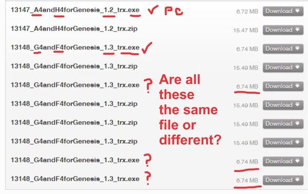

First question: In the image, those marked * appear to be the same file (same file size.) Note the first file at the top is for A4 and H4, and is the only file for those, so no problem. Then BOOM. We have newer versions, ALL for G4 and F4.
Note to newbies: PC users would use the exe, and MAC users the zips. See the problem? All the rest of the zips are identical and all the exe's are identical. Now, knowing this deals with morphs, are each of those files needed- the 3 G4/F4 1.3 trx.exe files? There are FOUR of those suckers!

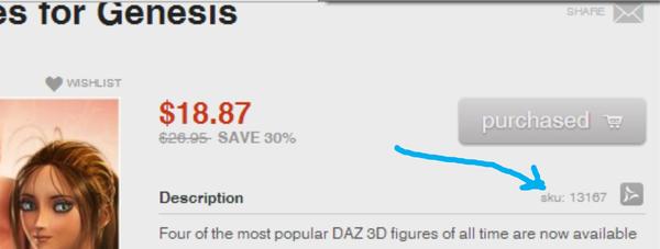

After some kind soul tells me what files to download and install, I'll check the ReadMe. (Tip: I need the product number. I find the product number as shown. It's on the product page, right hand side, towards the top. It's the SKU. Product number for this is 13167. Go to Help / Documentation Center / Product Read Me / and find that number.)
There is no Read Me. So here I am. Once I install this, where does it show up, what do I need to do with it to make the magic happen?
"This product contains no user facing files." Oh GOODY, I WAS SO WORRIED ABOUT THAT.....well, I would be if I knew what it meant. So.....????
    Hmm, no idea why they're listed repeatedly, there should be only 4 files total.
    It's a bundle, so there's no readme for it, just readme's for the 2 products in the bundle.

    I suspect the multiple files is a glitch. I bought the bundle but I in my Product Library not only do I have the bundle listed I also have the G4/F4 and A4/H4 shape packs listed separately. Notice the bundle doesn't have any DIM files, G4/F4 pack had the DIM files but no trx files, A4/H4 pack had both the DIM and trx. No tutorial, however well written, can prepare a newbie for these type of problems. Only the knowledge we old timers have gained from repeatedly bashing our heads up against them will help, so a note to tell the newbies to not be afraid to ask questions

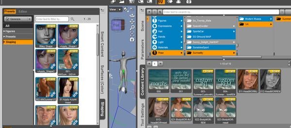

    1. correct, there are no sliders at all in Parameters tab, not even the head. I found Summer and see all kinds of fun stuff. Apparently I am supposed to use the Custom Inj (is that injectable? Meaning "adds to the figure" type thing? And REM would be remove?)
    2. If you have removed Genesis from the scene, you can find it in the Smart Content under Files/Default/Figures. (Will be over in Content Library too, I just used S.Content tab.) I removed it to start over as when I did some of the Summer stuff last night, I didn't see a change. If you will walk me through it the RIGHT way, I'll see if she's changing.
    3. I did see in the ReadMe "shaping on" So I headed to Shapes.
    4. Ok- tell me what to do first please?
    1964 x 865 - 231K
  • fixmypcmikefixmypcmike Posts: 19,710
    Generally the INJ/REM pairs are used for Gen 4 figures (morphs in Poser format use memory whether you use them or not, so they need to be injected to be used and removed to free memory). Genesis has all morphs pre-injected so the Shape icon just sets the values. I find it useful to have file extensions displayed, so I know whether it's a .pz2 or a .duf/.dsa

    There could be a couple of reasons why you click a shaping icon and nothing seems to change. Perhaps the icon is meant to shape V4, not Genesis (this definitely seems to be true of Summer, as she's a V4 and Genesis character). Actually I think everything in the Content Library side of your screenshot falls into that category...
    If you use V4 instead of Genesis, you do need to inject the morphs first before you can use them.
    The Shaping tab in 4.6 confused me too at first. Click on "Editor" at the top instead of "Presets," and you'll get back to your shaping sliders.
