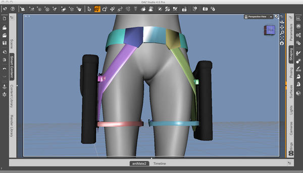

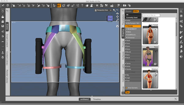

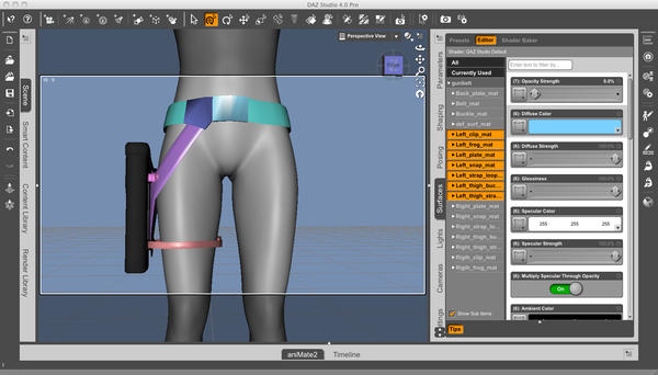

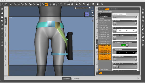

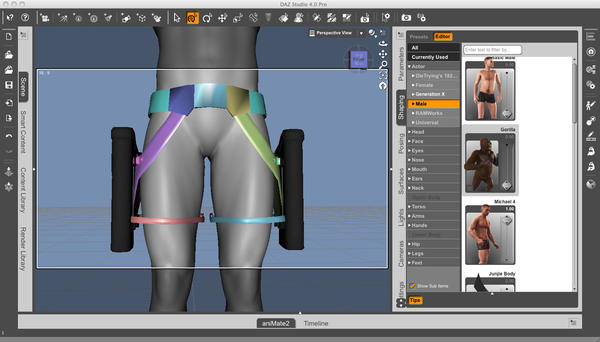

I'm working on a Genesis gunbelt designed for use with Prisomo's SF Weapons pack Barracuda holsters, and am running into a problem.
First, some technical info on the design. The belt is designed as a conforming figure onto which the existing holsters can be parented with straps and "clips" running through the D-rings on the holster to "mount" it to the belt "frogs" and secure it to the thighs. Through the use of separate material zones, it can be converted to a left-handed, right-handed, or dual holster configurations. The thigh straps are a part of the gunbelt assembly and pass through the holster's lower D-rings.
Now, for the problem. Whenever I apply a shape morph to the Genesis figure, such as the M4 or V4 shapes (forget using Troll or Gorilla), the straps and mounting clips no longer line up with the D-rings on the holster, and readjusting the position of the holster doesn't help because the parts of the belt involved are growing or shrinking/stretch and warping to fit the new shape, totally changing their relative proportions. I need this belt to be able to conform to different shape Genesis figures, including those with custom dial-spun characters made through a combination of several shapes, while still keeping proper alignment to the mounting points on the holsters. How do I do this? Pics attached:

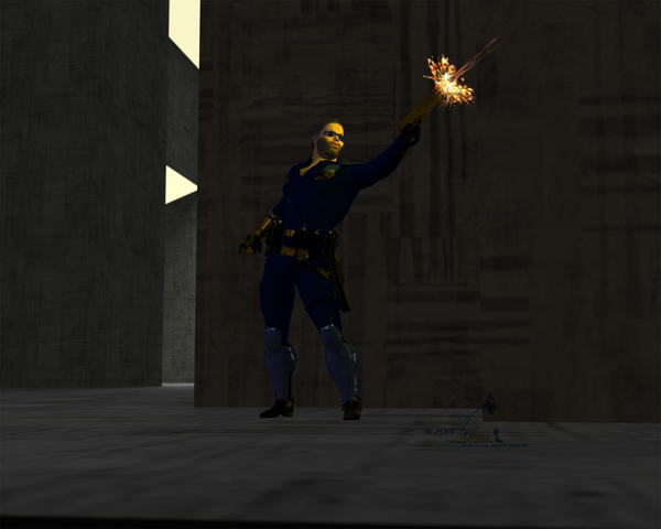

    I thought I'd raise this thread from the dead to show off the essentially completed belt in action on the guy it was originally designed for. Surprisingly, the only thing that it took to get the belt to fit right was removing the Michael 4 shape from the Genesis figure I use to make the character. I also noticed that the M4 shape was causing problems with my battle glove too; specifically, it was causing the claw blades to come out of alignment with their sheaths. It was those issues that have really kept me from using this character, even though he's the main character for my comic.
