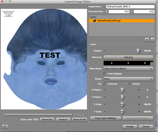

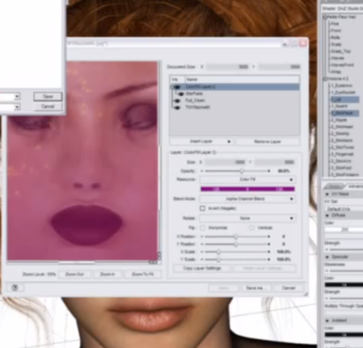

    The impression you are under is correct as is the fact that there is an included PDF. It may be that you consider the PDF to be sufficiently comprehensive to explain how LIE works, i can assure you it is not. Well let me qualify that, it is not explanation enough for me. I am watching the video tutorial at this moment, and i will probably have to watch it a few times for the messages to sink in. This is possibly a good tutorial were it not for some obvious drawbacks. First it is made for an outdated version of DS, which means that the look of things is different to the look of the current set up. The quality of the video is not that good, which means that in part i find myself struggling to read and translate things from the version of DS in the video to the one i have. Then there is a little button that is in the version in the video marked save as, i just checked and its not in the version i have, so i am starting to despair, i will attach screen shots. I see you have made over 7000 posts, so i defer to your superior knowledge, but i have to say that your comment has done nothing at all to cast any light on this subject. I do hope that this reply has not offended you, that is not my intention, my sole intention was and remains, to learn how to use the layer image editor. Doubtless there are many others who might need the same assistance.
    808 x 672 - 347K
    1139 x 1091 - 681K

    My man we are cool, I just could not tell if you had found the PDF or used it from your other posts. I only know of one LIE tut and as Szark pointed out it is Also for the older version of DS. If I find one more up to date I will link to it for you.
    That Link Szark posted is the best we have at this time for DS4.5 I believe.
