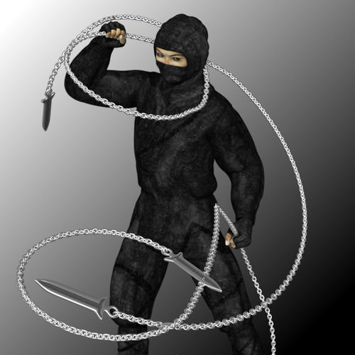

Why am I pestering you with this? Because it's an awesome native feature of DS4.5 that Poser lacks (the add-ons that make ERC controls possible are expensive external programs), and that we should all be using! Between the figure setup and how easy that makes it to create big bone chains and this, we could really have massive sleeves and trains, chain weapons, creature tails, and anything else your heart desires in the realm of big strings of bones. Some of you obviously know how to use it already, of course. But if you don't, please learn. It's so tremendously freeing to be able to do this with 4.5 Pro (and so much easier than trying to setup EasyPose figures used to be!).
I went over this in the Clothing thread, but in case people missed that:
A pose control is made by posing the figure, then setting up an ERC control for just that pose, thus resulting in a dial that lets that pose be dialed in to any degree. It is an incredibly powerful posing and animation tool.
I just checked it with my loincloth (which has a lot of extra bones) and a double-ended chain blade proof of concept, and here’s a workflow that seems functional:
1. Load the figure. Pose it in the position that you want to have as a pose control.
2. Load Property Editor again and right-click in the right panel. We’re still going to ERC Freeze.
3. Choose the clothing piece as your figure and ALSO as the Node.
4. For the Property, choose Create New.
5. For the Path, type Pose Controls. For the Name, create a name (MoveRightFolds, etc.) which should automatically copy to the Label. I’m not sure if having spaces will break the Name but it won’t the Label.
6. Leave everything else alone. Click Create. (N.B. With my weapon WIP I found I needed to uncheck the two options other than Create Controller.)
7. It will go back to the ERC Freeze options showing your new property. Click Accept.
Now you have a new pose control. The chain weapons in this pic were posed in about two minutes even though each has 79 bones (an anchor and two 39-bone chains).

    Thanks for the tutorial, Sickleyield. Nice to have a step-by-step quick reference, they're pretty easy to make but the property editor always gets me confused.
    Btw, that's some bad-ass chain blade you're working on. I bet my Naoki would look darn cool yielding that :coolsmirk:
    She wants it.

    Thank you. :-) These will work with any figure that can be used in DS4.5, but I'm definitely doing the presets for Genesis.
    Right now I'm thinking this POC project will go up at Rendo, and I will plan a couple of lavish weapons packs for DAZ (one more Western and one more Eastern/martial arts oriented). At last people will get the cat o' nine tails they've been wanting. That's not going to be as quick as this, though. Nine chains of 40+ bones, oy!
