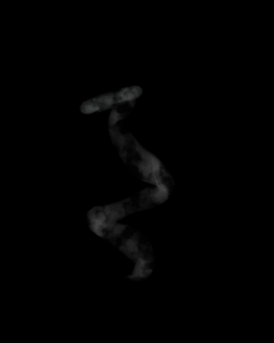

    Actually, you can use a cube...the cone and sphere are the presets. Just load one and apply the 'Uber Volume Base' to it...then either one of the three presets, Dust, Cloud, Smoke or play with the settings...
    Just remember, the camera needs to be outside the 'volume'.

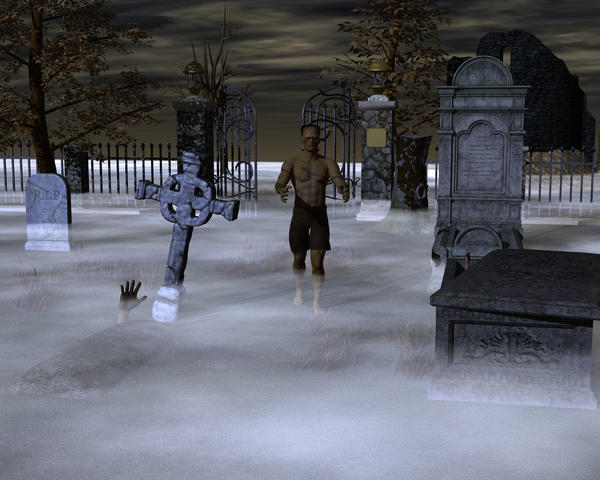

  • BWSmanBWSman Posts: 0
    An example of using a cube with UberVolume to create a foggy graveyard

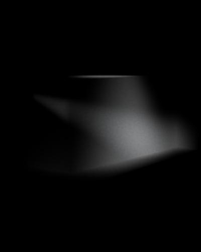

    Here's an interesting little item I cooked up, last night...
    800 x 1000 - 95K

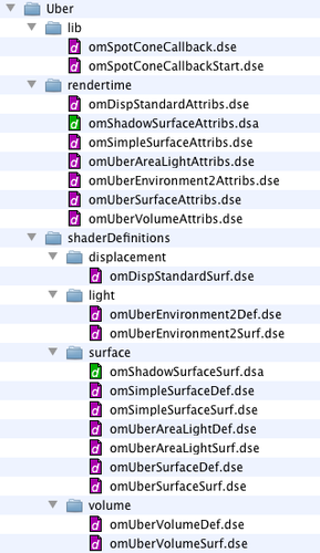

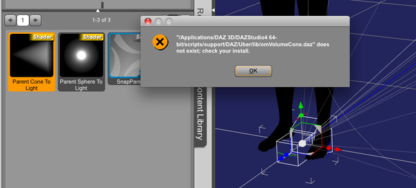

    Looking at all of these great shots makes me jealous! I am trying to perform the GreyWulf tutorial, and for some reason I do not some of have the scripts that seems to be required. If I do the tutorial, and first create a spotlight, select the spotlight, and then attempt to create the "parent cone to Light" shader, I get an application error that the script "omVolumeCone.daz does not exist: check your install". If I check the directory path indicated, ithe .daz script is not there: I see a lot of other UberScripts so I do have the system installed. See the screen shots below. Does anyone have any insight? I am pretty sure that I was able to access this BEFORE I upgraded my Daz to 4.5.1.56 but I am not sure.
    Any help or insight would be appreciated.

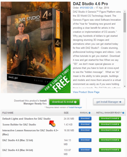

  • Jenkins3DJenkins3D Posts: 106
    edited April 2014
    I figured it out, no thanks to the support team...
    download the new Daz 4.6 lights and presets, that will fix it.
    Post edited by Jenkins3D on

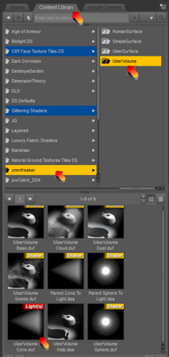

  • JaderailJaderail Posts: 0
    edited April 2014
    You need to Install the Default DAZ Studio Lights and Shaders content package to have the Cone. If installed Properly it lists in the
    Content Library Tab>Daz Studio Formats>My DAZ 3D Library>Shader Presets>omnifreaker>UberVolume...
