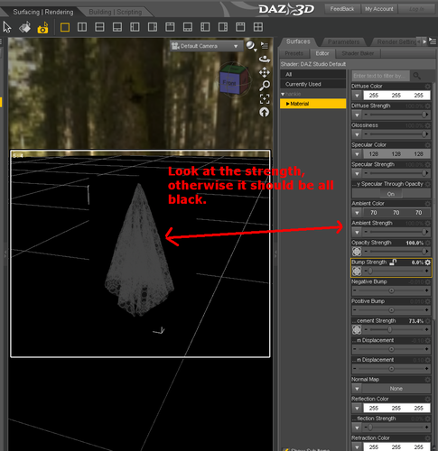

    Right...if the lights are off, it should be black...unless there is some ambient color and strength. set...
    896 x 923 - 221K
