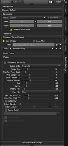

    Post your Advanced Render Settings which should look similar to the image below as some settings can be lowered to avoid crashes.
    OpenGL renders are pretty poor and will not show a lot of surfaces properties when rendered. I aviod OpenGL totally.

  • SteveM17SteveM17 Posts: 1,061
    Here are my settings (I have no idea what most of this means):
    659 x 902 - 64K
  • SzarkSzark Posts: 10,634
    Here you go try this http://www.daz3d.com/forums/discussion/15210/#222187
    The only setting I can see you dropping is Max Ray Trace Depth to 0. 1 or more are for things like reflection and refraction so for now try 0.
