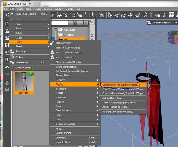

    1. load the clothing (for V4 or M4) (cape or mant etc, I use Roin,, but it seems same) only
    2. Edit>Figure>Rigging>convert Figure to weight mapping
    then save it as subset. to keep the weight-map figure.

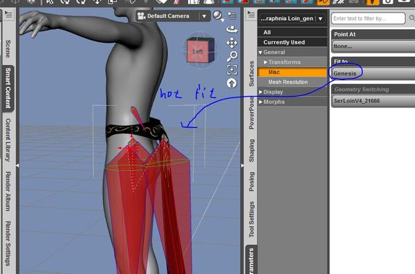

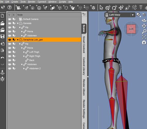

    3 Now the new figure may be keep the original morphs and rigs. only change weight mapped
    but, when Fit the Fgiure to genesis,, it can not fit well. because rigs are different from
    genesis.

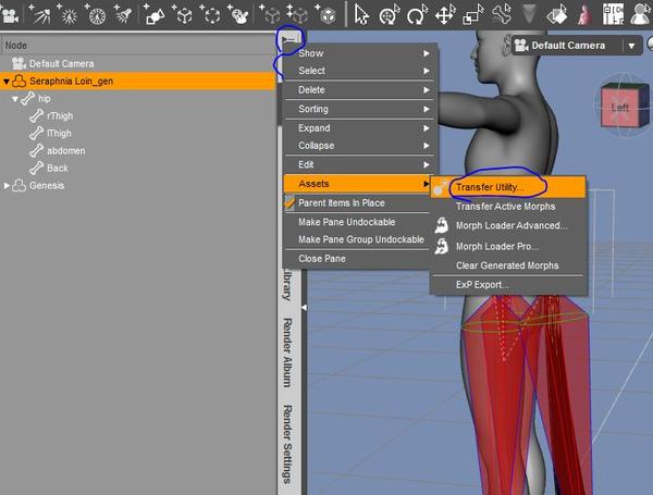

    4. so that I need to trasfer rigs and weight-maps (with keeping ghost bones and morphs)
    load genesis.duf , then in scene tab, click option menu ,
    asset>transfer utility.

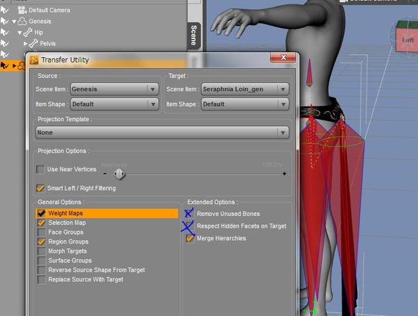

    5 Usually,, of course I set clone for Source, but on this case,, I did not set Clone.
    because,, about roin or mant,, it seems easy to change scale,, and modify fit to genesis shape.
    if I use reverse option, it make the mant mesh not so good shape. I know, apply smooth modifier
    and re-export inport , work well,, but just change scale is more simple.
    so need not set item shape , keep default.
    check point is,, how to set option.
    I do not use projection template about mant etc, so set type none.
    general option,
    check on weight map,,thent click, weight map , and set Extend option
    check on only "merge Hielarchys" , I believe it do not remove ghost bones.
    check on Selection Map
    Region groups
    check off Morph Target. because,, I need not transfer morphs from genesis and projection.
    see my pic please. on this case,, need not Reverse Source Shape From target.
    (I modify scaling, after transfer morphs etc)
    click accept

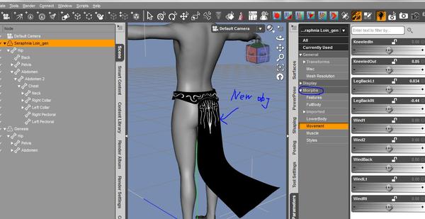

    7 if you need to modify the shape which more fit to genesis,,
    export it as obj. then, re-import again.
    I plan to the scaling then, translate more good positon,,

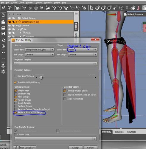

    9 import the new roin.obj to ds. now need scale 100%
    then use transfer utility again.
    on this time,, Souce is the figure which you saved step6, target is the roin.obj
    then check option,, "Replace Souce with Target", it just exchange the base obj shape,
    with keeping other weight-map, Morph targets etc.
    it is useful, when adjust shape or scale,, or positon of the figure.
    10 Now you can see,, the shape exchange to obj,, but it keep the figure name, rigs
    and weight-maps and morphs too.

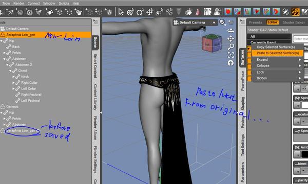

    11 after that,,,, we may need to remove, unused bones by joint editor,
    then assgine weight-maps for ghost bones . before use weight map tools and joint editor,
    lets save it as new figure and prop again.. this time I saved it as roin3.duf,,
    now you can see,, the material seems change,, but,, it keep original surface group,
    so if you hope to keep it,, Just copy and paste the materials from original,,
    or if the product have material preset, it must work. (I do not change UV, and surface grouping)

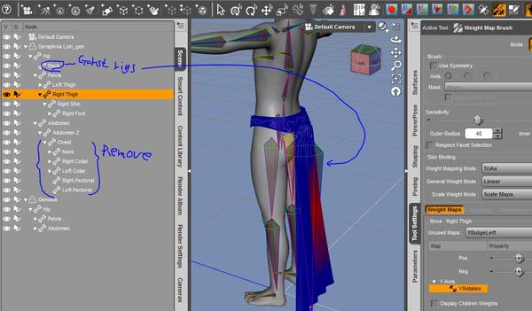

  • kitakoredazkitakoredaz Posts: 3,526
    change ghost bones parent
    correct rigging bones
    when I keep ghost bones, and use transfer utility,
    sometimes need to change parent.
    I plan to color triax weight about Back bone. but,
    as you can see,, now Back bone7s parent is Hip.
    so that if I bend Plevis,,
    it can not follow the movement,,
    In picture,, I set weight map to back for test. it remove weight map which assigned to Plevis from the back roin part.
    so that when I bend plevis,, as you can see,, back can not follow the plevis. it may difficult to adjust the shape,
    when pozing.

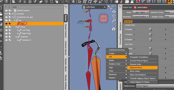

    so I need to change parent of back bone to Plevis.
    1 open Joint editor, (change tool)
    then select the back bone. edit>Reparent bone.
    then select plevis.
    you may see,, caution window,, but do not care,, (because you have saved,, figure already,,@@:)
    go ahead.

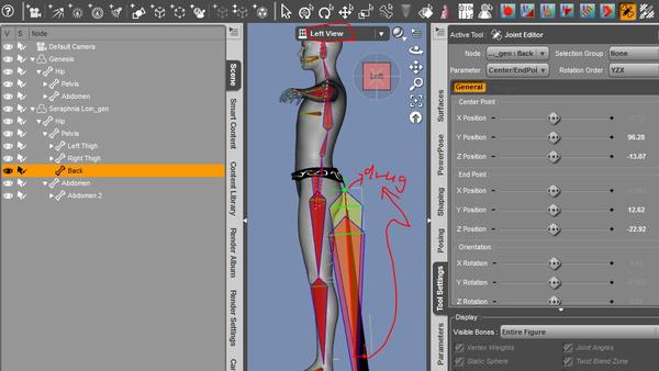

    2 By joint editor,, I change center positon, and end positon.
    I plan top area of back roin can be effect by plevis weight map,,.
    (if you hope you can spilit bone,, and more smooth poziing, but may product have
    morphs for movement,, and it can work still,, so I do not spilit bones)
    decide, end and center positon, Align>node,
    then, memorize>selected node rigging
    save it as new figure prop. eg roin4.

    I color weight map for back bone. and adjust other bone weight too.
    before color weight, I needed to remove bones which need not color weight map.
    use Delete>delete bones ( you never used unused bones,, untill you set weight color,
    it remove your ghost bones)
    (I made mistake,,, ,, if use projection template may work better,to remove other bones,
    but on this case, I manually,, remove bones by joint editor , one by one,,,, ^^;
    I often remain bones, untill finish color weight,, because,, once remove bones,,
    never get buck it,, and if the removed bone was assgined weight already,
    ,it make me difficult to adjust other bones weight,
    so in this case,, I remain abdomen 2, and both of Shin,,)
