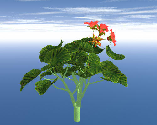

    They look to good to be true and you know what they say about that....it showed up (can't spell) transparent in paint .net I downloaded them in .3ds and I found out if you click on each of their boxed products you get a sample from each of them also...I hope this works out I need some new trees and bushes also. I will try what you said in Bryce....Thanks Trish I did an edit on this post I just tried one of their flowers on a quick render and it imported good and looks alright

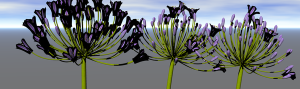

    I see now that it is not ok some of the petals have a black area around them they give you 3 of the same flower each one with more petals but no leaves... this is silly it can't be a transparent problem if some of the petals are ok???? Its the flowers that are open I will try again and check the pictures that came with them

    I guess the petals that are closed are all geometry and the open ones use a transparency map.
    It doesn't matter if the pictures have transparency in a paint programme because as far as I'm aware, Bryce doesn't see alpha channels like that... Which may be the problem.

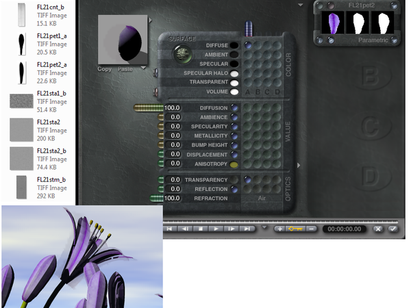

    ok heres my settings in .mat lab and I killed off all of the .tiff that had any black or grey and I still have a slight square shadow but maybe that will be ok when not viewed from this close...I don't know oh well it was worth a shot I wish you a better outcome.

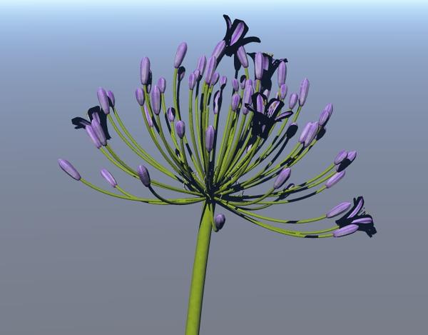

    ok got rid of the shadow changed the image format to .PSD sent in the leaf as a photo to Bryce but I don't think I am willing to go through that with each tree and bush leaf.........Huh .......

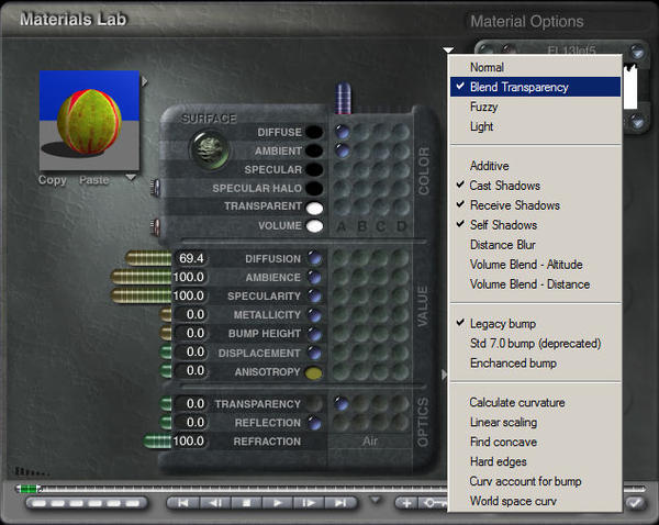

  • HoroHoro Posts: 11,685
    edited January 2013
    A also have some X-Frog plants. I had importet them and sent to the Objects Library. Since the leaves and things have picture materials, the Blend Transparency has to be enabled. Unfortunately, they cannot be set to translucency anymore, as we can if we use procedural materials.
    First picture shows what I took from the library.
    Second shows that you have to select each individual mesh.
    Third shows that you must make sure Blend Transparency is checked.
    Fourth shows a quick render.
    Hope it helps.
    Did you make the transparency white using the HLS settings?
    Because it looks like your white isn't pure white.
    My render finally rendered and I've had a quick look and mine works after the tweaks I suggested.
    Yes, it's a bit of a pain having to do that, but at least the models don't seem to have many components, so the one I did only needed 7 parts altering in the mat lab.
    To get the HLS settings, click 'Option' when you click on the little colour preview oval.
    This opens up a window where you can directly dial in colour settings instead of using the rather 'hit and miss' default colour picker pallet.
    At the bottom of the window that opens up, you need to click the HLS setting and the middle row (the L setting) needs to be at 255.
    That will make sure your colour is pure white and then the faint grey box should disappear.
    Sorry if I'm telling you stuff you already know. :)

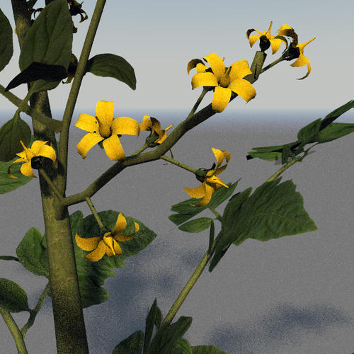

    The full plant rendered out with higher render settings and saved out as HDR file... I might have desaturated the colour a bit too much.
