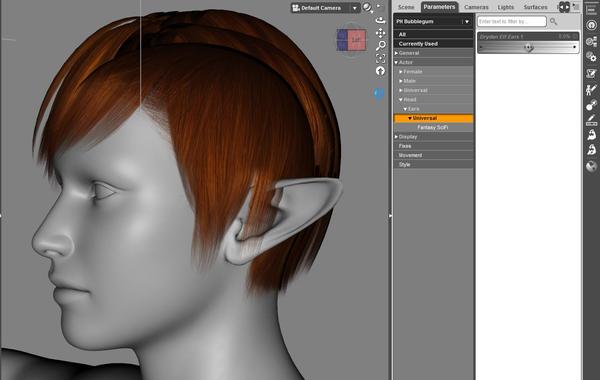

    Here's how to fix that.
    1. Select the hair, go to the Parameters Tab.
    2. On the Active Pane Options (white square upper right on the Parameter's tab), select "Show Hidden Properties"
    3. You'll see the morph for the elf ears the hair has applied.
    4. Just dial to 0 and the hair will return to it's normal shape!

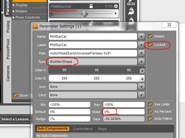

  • kitakoredazkitakoredaz Posts: 3,526
    edited January 2013
    Something worth noting is that turning off (or on) auto-follow on a morph after followers have been fitted to the character won’t make any difference until after saving and reloading. .
    dan.shive is right.
    change auto-followed morph parameter value to zero , as Lindsey telled.
    it must work to remove problem about current status. and it must need.
    once morph generated to the hair. "check off " auto followed can not work.
    need to remove and reloading the hair without fit- to, then check off "auto-follow"
    save it as morph, or save modified assets, it keep "non auto-follow" permanently.
    the way is tweaking genesis morph files.
    another way is tweaking , change "auto-generated" morph, type as "overwritten original morph" of the Hair
    then save the locked condition.
    1 ,sellect the "hair"
    serch auto-followd morph, as Lindsey said, on the controller, use parameter setting,
    type change "Modifier/shape/generated" to " Modifier/shape"
    then lock the value as zero. or use limits. then "0" min "0" max, may work.
    it can work about the scene or scene subset which saved as.
    (it simply, as if overwrite auto-followd morph with your setting,
    but actually I did not "save the morph" again.)
    if hope to keep the setting about Hair, parmanentlly, I may need to save it as morph, or use, "save modified assets" about Hair..
    then overwrite generated morph, by original setting morph.
    after that, the morph are saved , as one of original hair morphs in morph directory of the hair.
    keep the "locked value"
    (edit "rock" to "lock" @@;)
    597 x 446 - 58K
    Post edited by kitakoredaz on

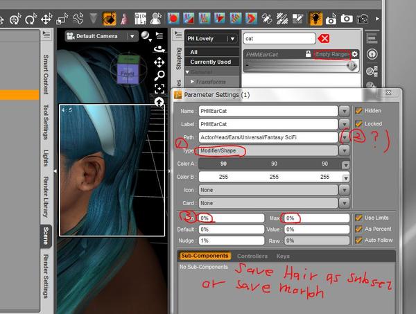

    1 change type to "modified shape", of the generated morph to the hair.
    2 check on use limits , then min 0 to max 0, (Empty Range)
    the morph can not work never.
    3 save the hair as scene subset,(or save the morph again,,)
    I can use the hair subset , (or the hair,,if save as morph)
    which can not generate the genesis ear morph any more.
    when tweak genesis ear morph,, ds try to generate morph.
    but,, the hair has same name morph already,,
    and the morph can not work, just keep zero value ^^
    it seems best way for me.
    (if only change value to zero, and lock ,, when off fit to from genesis,
    the hair set value the morph as minus value, then lock the value.
    it seems not good so need to use limits,, ^^; )
    854 x 645 - 104K
