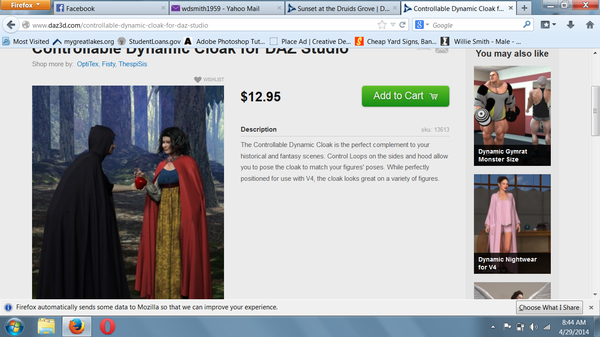

    It is this one: Controllable Dynamic Cloak by Optitex. I am using DAZ 4.6 and cannot get it to work at all.

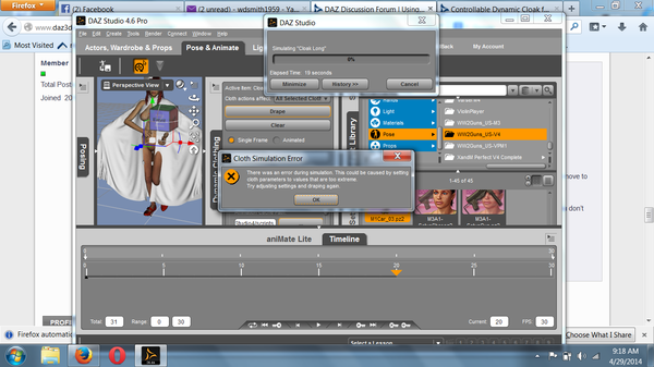

  • wdsmith1959wdsmith1959 Posts: 60
    Ok....I tried the animation thing, and it still won't freaking work! I keep getting that error message!
    1366 x 768 - 364K
  • SzarkSzark Posts: 10,634
    did you change any of the cloth settings? If so load a fresh copy and save as a new scene and then try again. Or better still take us through the steps you did.

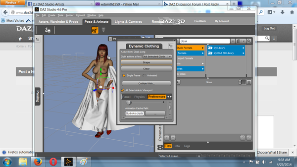

    Ok....I right clicked and changed parent. It is supposed to be for V4, but... I had to go in and make V4 the parent. I am attempting to get it to drape over the shoulders and the left arm holding the rifle. It won't lie on the shoulders. This is what it is doing now...
    1366 x 768 - 356K
    well for starters I see you have not set the Drape to animation.

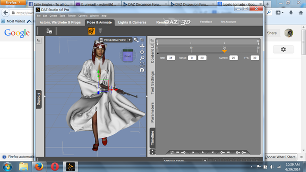

    Well, it is doing SOMETHING finally! LOL! The next thing is figuring out how to get it to let the hands stick out from the cloak. I need the chest, forearms, rifle to be visible with the cloak draping over about the elbows....
