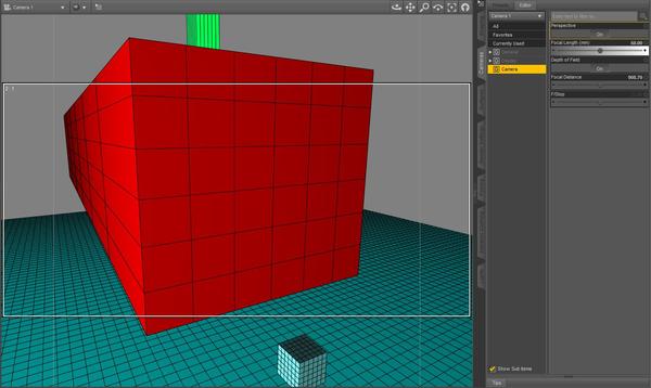

  • Rayman29Rayman29 Posts: 0
    Does anyone find changing render dimensions to a landscape format breaks the camera focal length.
    1850 x 903 - 89K
    1851 x 905 - 178K

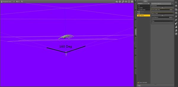

  • srieschsriesch Posts: 4,243
    Another quick test to see the effect change: try putting a figure in the middle of the scene and a cube along the very edge of your scene (to simulate an interior wall corner, a building, a support post, etc. render. Make a huge change the focal length, then move the camera in/out to compensate, render again. You can cause/remove distortion to the angle of the (supposedly) perfectly vertical line of the cube by doing this.
    Increasing the focal length is a workaround for the error true. It makes the camera settings a little meaningless though.
    I reported it as a bug, but the response was basically 'No its not'.

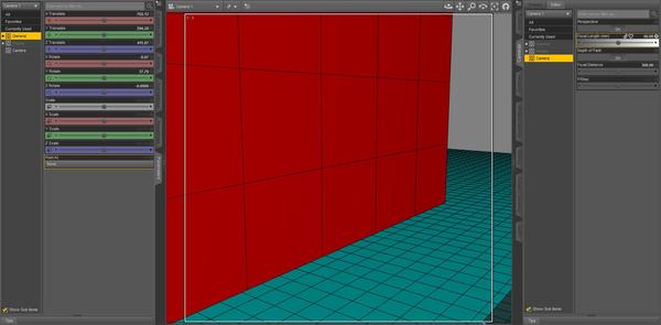

  • JaderailJaderail Posts: 0
    I'm not seeing what you are in DS4.6 at 50mm but my focal distance is not set to 200 something either.

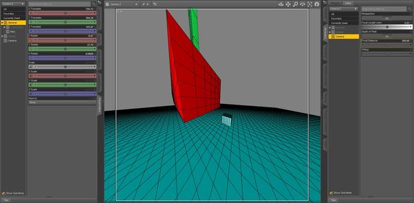

    edited June 2014
    This is what I get with Render Dimension set to 10:1 with 50mm Focal Length camera.
    Note that the 10:1 render dimension setting has effectively reduced camera focal length to 5.53mm.
    1842 x 904 - 207K
    Post edited by Rayman29 on

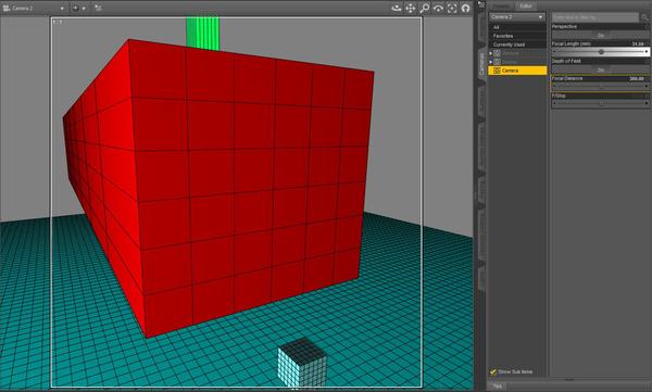

    And this with Render dimension set to 1:1 with 5.53mm Focal Length camera (extreme wide angle).
    1842 x 906 - 209K
