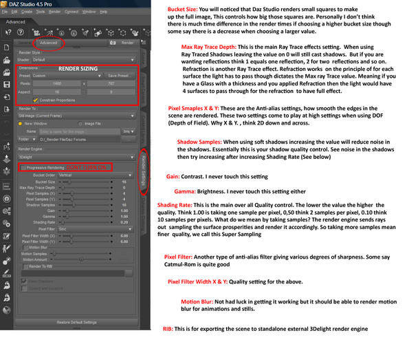

I have no idea how to set up the render screen...is there a basic tutorial showing what the different sliders do on the advance settings and even just setting the dimensions settings. I turned on the show aspect frame so at least I know what part of the scene I will get and then I try to frame the part of the scene inside that. But when I render it seems so huge and close instead of back like I thought. So obviously my settings are incorrect.....

    For normal renders I usually use default values for most of the advanced settings, except for:
    Shading Rate - I reduce from default 1 to 0.2. This will increase render times, but it will reduce the noise too.
    When I use depth of field effects on the camera I had to increase Pixel Samples X and Y from the default 4 to 16 to reduce the noise. When not using depth of field effects, I have left it at the default value.
    Are you using cameras for your renders or just the perspective view. When you add a camera you can control the focal length of the camera which effects the perspective of the photo.
    Added: I found this thread in the old archive that explains the advanced render settings: http://forumarchive.daz3d.com/viewtopic.php?t=144303

  • SzarkSzark Posts: 10,634
    Well you gave me something to do in the ealry hours on the morning. Spent a few hours getting this together. And if I have got things wrong or confusing then blame 3.00 am in the morning and pain. :) Seriously I have most things covered without going geek. :)
    Also these links might shed some more in depth light to certain settings
    Are there any recommended render settings?
    Optimising Render Settings in DAZ|Studio This is old but I still think it has some good information still.
    1200 x 1014 - 662K

    thank you mark szark...this info will help alot! and the links I was using a camera and tried different settings , nothing was looking like I thought it should. another question...when you set the dimensions how does the pixels and aspect ratio compare to the size of the finished render...say I wanted my image to be 5x8 or 10x12...how would you set the dimensions. Sorry I have always had trouble wrapping my head around that

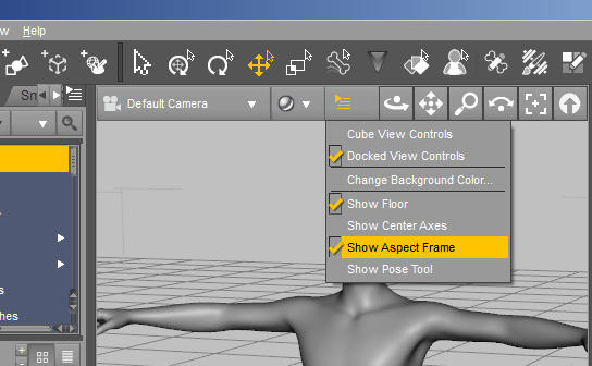

    Say I had set up my scene, then go to render, I never seem to get all of what is in my screen into my render, so I assume I am setting the dimensions wrong. Is there a way to know what size your window is in Studio so you can set the render dimensions so you get all of your frame in your render?
    What you need to do, is check the 'Show Aspect Frame' option in the viewport menu as shown below. This will show you the area that will be rendered, depending on what your Render Settings for the Preset you have chosen.
    544 x 336 - 93K

    So I have aspect frame turned on already ( as mentioned in first post) so I am going to try your suggestions for settings and see what I come up with, hopefully it will render what I am thinking it should. Then on to tackle lighting (so much to understand...so many topics to read and learn...lol) loving every minute of it :) hopefully not making everyone else crazy with questions
