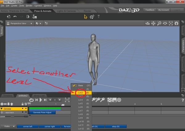

  • Arnold CArnold C Posts: 740
    magne said:
    It still leaves me with the stupid feet problem, any elegant way to fix this.
    There's a "Pose Adjust Script" created by DavidGB available at "shareCG" (http://www.sharecg.com/v/60135/related/21/DAZ-Studio/Genesis-V4-pose-adjust-script) which adjusts the zero pose of Genesis to that of V4.
    With that you're able to create a new aniBlock to be used in a Sub-Track to correct the posing value differences between Genesis and V4/M4 in aniMate 2.
    The steps I did to create the new aniBlock:
    1. Load Genesis into the scene
    2. On the "Timeline" tab set FPS to 30, create a keyframe for and inject the pose at every single frame (from frame "0" to frame "30").
    3. Switch to the "aniMate2" tab, rightklick it and choose "Create aniBlock from Studio Keyframes".
    4. Rightklick the new aniBlock and choose "Save as new" and name it "Genesis Pose Adjust" or anything you like.
    When you now want to animate Genesis, create a Sub-Track at the "+" icon in aniMate2 and drag the pose adjust aniBlock there.
    On the main track, aply the aniBlock you want Genesis to perform. See the weird feet being gone.
    I tested this on some of the aniBlocks I own and it works on aniBlocks created for both V4 and M4. The script not only corrects the feet, it also corrects the thigh and collar posing. One of the most useful scripts I own. :)

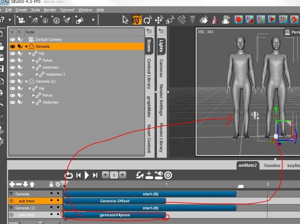

  • kitakoredazkitakoredaz Posts: 3,526
    edited January 2013
    Hi Stefan,, yes,, the poze script file work good ^^
    I iinslalled it few months ago,, then I forget this script.,,
    so I made aniblock by myself to correct genesis node rotaiton,,,,
    but,,the script work more better ^^; thanks much.
    then,,, if you have animate 2, you need not record every keyframe(0 to 30)
    from daz timeline, with the fix poze ^^;
    just add empty block , in animate 2 timeline, first
    then go to key edit mode.
    on first key frame, select genesis, (with zero poze),
    then apply the fix poze file.
    it record changed node rotation on the first key.
    then save it as new aniblock .
    when set aniblock as sub track, you can decide the subtrack how work.
    dobule click the yellow labelled "sub-set" area on the left side,,
    the sub track property window will open. select Add (aniblock extended influence)
    only record one key,, it can adjust all key. :lol:
    872 x 599 - 102K

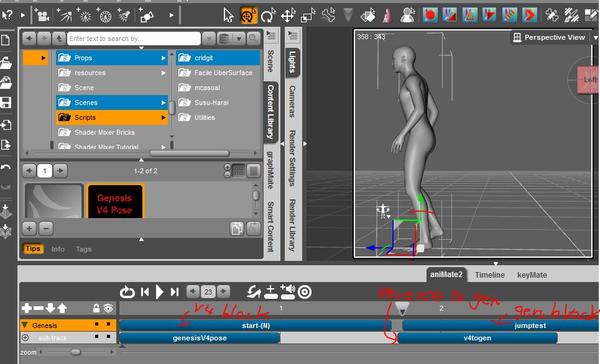

    I undersatnd (then I am perfeclty beginner about animation too ^^;)
    I strgulled with how aniblock work correctly or how to set sub-track
    and I could not apply well aniblocks before,,,
    I saw you tube video first,, then missed some points to use aniblock correclty.
    and every model on tutorial video is V4 or M4,, so,, something different I felt ,,,
    but go figure made good manual about animate 2,
    and almost everything were written there.
    and,,,,
    set sub track,, as "add extended influence" to correct genesis poze,,
    but I have original aniblocks which fit to genesis too.
    so that I made reverse aniblock which change V4 fit poze to genesis zero poze.
    (it is easy ,, first apply the script (which correct genesis poze to V4) to genesis,
    then select genesis,,
    make empty aniblock , go to first flame, "zero poze"
    it make reverse poze aniblock.
    so if I hope to use V4 aniblock,, i use the gen to V4 poze aniblock on sub-track ,
    then when apply genesis aniblock, I apply the V4 poze to gen zero aniblock on same sub-track,,
    (Hope it may help a little ^^; sorry if you know already,, )
    And,,, genesis aniblocks,,, I hope too,, (I requested many times ^^;
    but,, may need more genesis and ds user?!
    965 x 586 - 104K

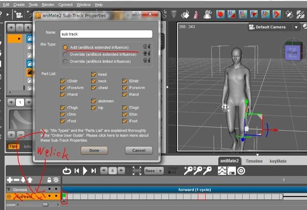

    edited January 2013
    if you only use V4, or M4 aniblock I first apply the sub-track once only. so I said.
    but to use other aniblock which fit to genesis on same Animate track,
    I need to set reverse sub-track.
    I know you are professional about animation, so you can easily adjust the genesis pozing,.you may need not to
    use genesis off-set. and Pose Adjust Script.
    the go figure offer off-set is useful who start genesis animation with an block,at first time.
    but when you set the genesis-off set as sub-track and use other ani-block
    it is not so fit with many V4 ani blocks.
    so user may plan to adjust the key by themselfs about some node.
    simply because,, the "genesis off set" change only both foot rotation and
    recorded it on first key frame. I think.
    on the other hand, the Stefan47525 recommend David GB free ajust poze tool can fix more and more.
    it is amazing for me.
    I recommend “Pose Adjust Script” created by DavidGB , than genesis off-set (go-firuger simply remove foot problem
    to genesis user can try aniblocik,, I think,,)
    860 x 642 - 95K

    About your right arm posing, you could try and select a different Level.
    For that, leftclick on the aniBlock you're using on the main track and choose "Go into Keyframe Mode":
    [See Picture 1]
    Then, leftklick on "Base" and from the dropdown list choose another Level.
    (Most people seem to prefer "Level2". Don't ask me why, I haven't got a clue :-))
    [See Picture 2]
    Then you can move your right arm into pose by using the parameters tab or by using the "Universal Tool".
    Once you are satisfied with your animation you can rightklick on the aniBlock you just modified and choose "Save as new".
    After you're done don't forget to set the Level back to "Base" or it it will stay on the Level you have chosen. It won't be revert by itself.
