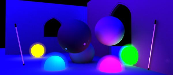

    Ultraviolet (Black Lights) Simulated
    The scenes from Avatar and night time on Pandora made quite an impression on me. So in my inspiration I’ve completed a light set that resembles the Ultraviolet /Bioluminescence.
    • The blacklight props are just that- props and have no real function.
    • I’m using UE here (Set HDR FullMoon setting)
    • Each globe has a slightly larger uber volume sphere surrounding it.
    I’m really happy with how this is looking. I’m trying to reduce the amount of grain and noise in my shadows and found that reducing the shading rate had the biggest effect on clearing this up. I tried using 2 distant lights (pointing up and *down) instead of the UE and it works pretty well.
    * The distant light pointing down had raytraced shadows/ softness at 40%.
    what do you think?
    995 x 432 - 170K
    Post edited by Marshian on

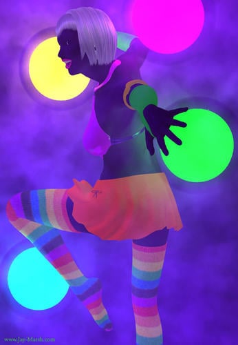

    Simulated "Blacklights" in Action
    I'm really happy with the "blacklight" test above so I composed this scene (straight out of DAZ w/no retouching). There is a lot going on here to make this work- Multiple Ubervolumes (around spheres and filling scene), 4 point lights, 2 distant lights and a lot of materials/surfaces work with V4 and clothing.
    Reference shows skin in blacklight goes really dark- that's one of the effects here that makes this more believable.
    450 x 650 - 215K

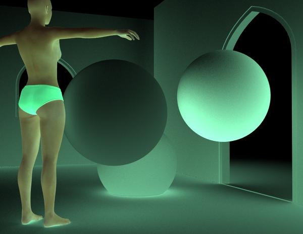

    Glow-in-the-Dark using UE2
    So what's next? How about Glow-in-the-Dark with the UE2 Softbox? I've tested this light with other props and it works best when there isn't a complicated surface texture. Such as- a bathtub is going to look better than a plaid couch.
    I couldn't resist making the undies glow by dialing up Ambient in surfaces tab.
    600 x 465 - 141K
