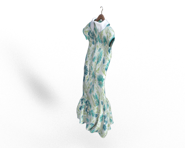

    Well, here's a quick 'proof of concept' trial...
    I used Blender to 'clothify' G3F and 'pinned' parts of her in place before running the sim against the hanger prop.  I did a quick smooth/cleanup of the mesh before exporting back to Studio.  Then I loaded the 'hanging' G3F through Morph Loader, fit the dress as usual (it's Wilmaps Princess Line dress for G3F), hid G3F and hit render...

    Glad you found a solution to your needs.
    Oh what hoops we have to jump through! I wish DAZ would update DS with a system which would clothify any object (as in Poser, Blender etc)... or ask a PA to write a plugin to do that... it would save us so much hassle!
    you could share that morph if you wished too.

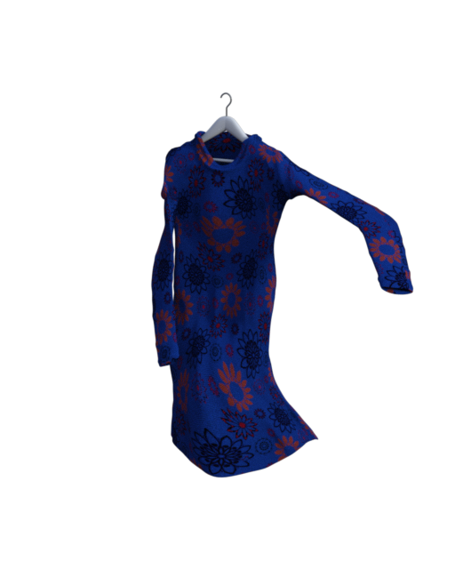

    I made a couple of changes, so now the rigging, while adjusted is closer to the original, so the morph will accept poses and the pose controls are useful.  This basically means if you can pose G3F into a 'draped' position, the clothing will follow along.  Also, there's a lot of control in what you can do with it...
    (oh yeah, it works with long sleeves, now, too!)
    Depending on the article of clothing used, you may need to switch the collision object to the hanger or whatever you have the clothing draped on.
    Another thing that is easy to do with this:  Put the clothing item on G3F and morph and pose it.  Then make sure the clothing is at base resolution and everything, except it, is hidden.  Then export it as an obj, then use Morph Loader it import it as a morph for the clothing item.
    I'm not quite sure how soon I'll post it, but it should be sometime this week.

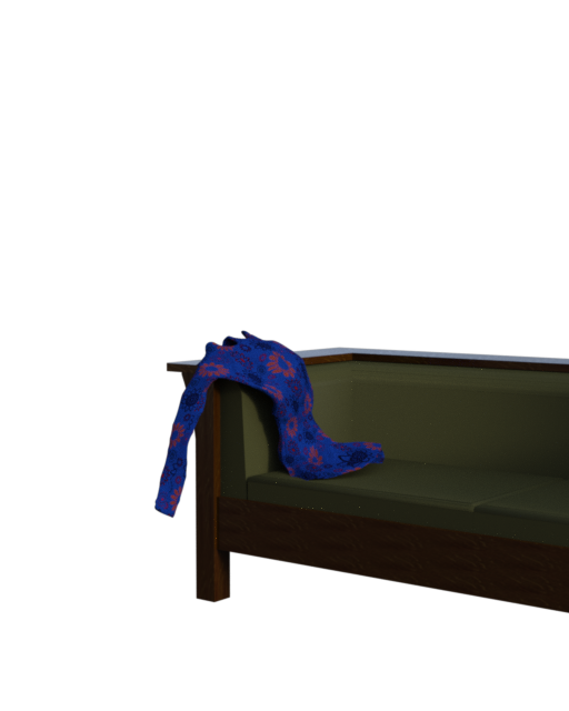

    I should be able to post it tonight...final tweaks are done and saved out.   I'm not going to bother with any correction morphs, so on some items there can be some stretching/distortion in the chest area, but for the most part it's worked on most dresses/shirts I've tried.   One other 'problem' area is with items that have high levels of modeled wrinkles...those don't smooth out like they should for a hanging item, so I'd probably avoid using those for hanging items.
    Since I went with keeping the original t-pose/rigging close to 'standard', you'll have to pose the arms/sleeves to preserve the hanging effect, but there is a lot more control doing that, than the way I had originally set it up.
    Broke all the limits on the pose...but...
    And if this proves popular, I may be convinced to do a Genesis/Genesis 2 set...which would really expand the stuff you can load a closet with (or throw around a room).
