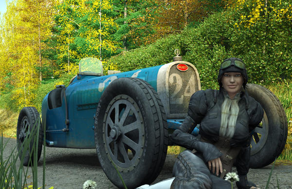

This is my first go at Carrara and I have worked out a lot of things but have hit a brick wall trying to pose V4 and get the clothes looking right.
Is there a way to pose V4 without using the translation tools that I haven't found yet also how can I stop all that poke through that I am getting.

    Thanks 3DAGE, with your help I was able to work out some of the things I have been doing wrong.
    I can't post the results here yet as project is a wip for the New Users Contest, but if anyone wants to have a look http://www.daz3d.com/forums/viewreply/171856/.
    Would love some feedback if people have the time.

  • 3DAGE3DAGE Posts: 3,311
    Very nicely done Bluemoon :)
    I agree with Szark, moving the camera slightly,.. to get a better composition,. would be a good idea.

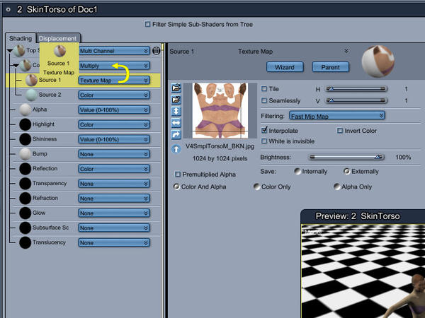

    Some pics and info, to help you in adjusting the shaders..
    Once you've got your V4 shader tree open,. you'll see the diffuse channel is a multiplier, with the texture map, and a pale green colour.
    Select the texture map channel, and drag 'n' drop it onto the Multiplier channel above it. (see pic 1 )
    This will change the diffuse channel to just the texture map.
    Do that for all the other shaders in the figure,. (Some won't need that change) and you're good to go.
    You can save all of those shaders for the figure, as a "Global" shader,. by dragging the Multi-coloured ball, at the top of the shader list, and dropping it into your "My Shaders" foldr in the Carrara Browser.
    Then you can reload that, and apply it to a figure, by dragging it from the browser, onto the Multicoloured ball at the top of the shader tree for your figure.

    Thanks for the great info 3DAGE, I will have a go at saving the shaders for V4 today and try out experimenting with shaders on some primitives.
    Here is the finished render I have been working on, also did a postworked version of it but don't think I can post that one till the end of the month as it is my entry in the competition.
    800 x 520 - 272K
    Looking good so far :)

    bluemoon: that is a truly fantastic image! Bravo!
  • edited December 1969
    Thank-you very much Garstor :-)
