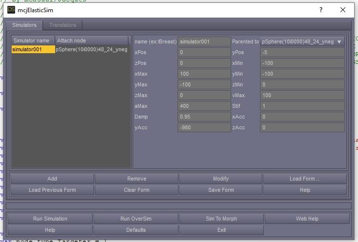

     note that you can also re-position the simulator's base node "manually"
    do it when the timeline is at frame 0, to avoid having the base node move during the simulation
    if you select the simulator 'sim' node, you can also set it's initial position ( at frame 0 )
    if you go in the daz studio parameters tab for the 'sim' node, you will find all the simulation parameters in a sub-section named mcjSomething
    you could tweak the parameters there too
    when you intend to  target a specific morph or joint rotation, it's better to test them manually
    so you can see the limits and the ranges
    some breast morphs have a usable range of -100% to 100% ( -1 to 1 in mcjElasticSim parlance )  others need -800% to 800% !
    in the case of Genesis 3 i think, i had some confusing  results when "driving" the 'pectoral' joints, but it's worth the try
    personally for limb animations i use rotations and avoid tranlations

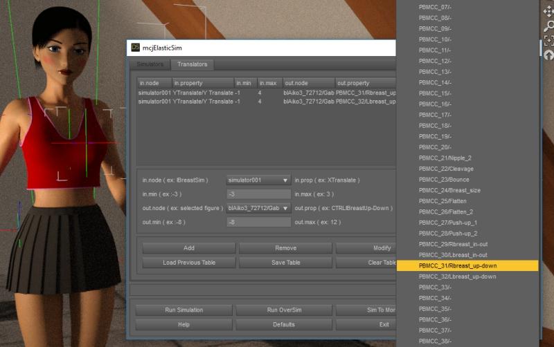

    UPDATE - UPDATE - UPDATE - UPDATE - UPDATE
    the script now displays the list of properties
    as pairs of Name / Label
    because, when a morph is injected into a figure, the channel name remains something cryptic like PBMCC_1
    in the first version of the script we only displayed the property name
    the new version displays them as pairs of Name / Label
    800 x 502 - 177K
    Post edited by mCasual on

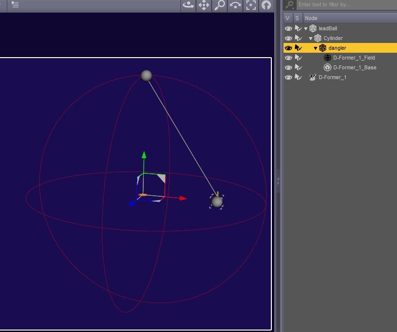

  • mCasualmCasual Posts: 4,607
    i had a more complex test animation in mind but this shows i was able to convert the red ball X Translation ( -10 cm to 10 cm ) into a stick (cylinder ) Z Rotation ( 10° to -10° )
    http://orig02.deviantart.net/345c/f/2017/099/1/5/mcjelasticsim_script_for_daz_studio_update_by_mcasual-db59qhd.gif
    edited April 2017
    second update
    this update fixes the issue wherein the list of property list was duplicated each time you change the node selection in the tranlators Tab
    https://sites.google.com/site/mcasualsdazscripts5/mcjelasticsim
    note: i used mcjParent to make the small ball follow the simulator node
    because when it's parented to the simulator node its local transforms dont change
    and the translator system in mcjElasticSim is based on local transforms and morphs
    someday i may (should) add world-space transforms as source/destination "properties"

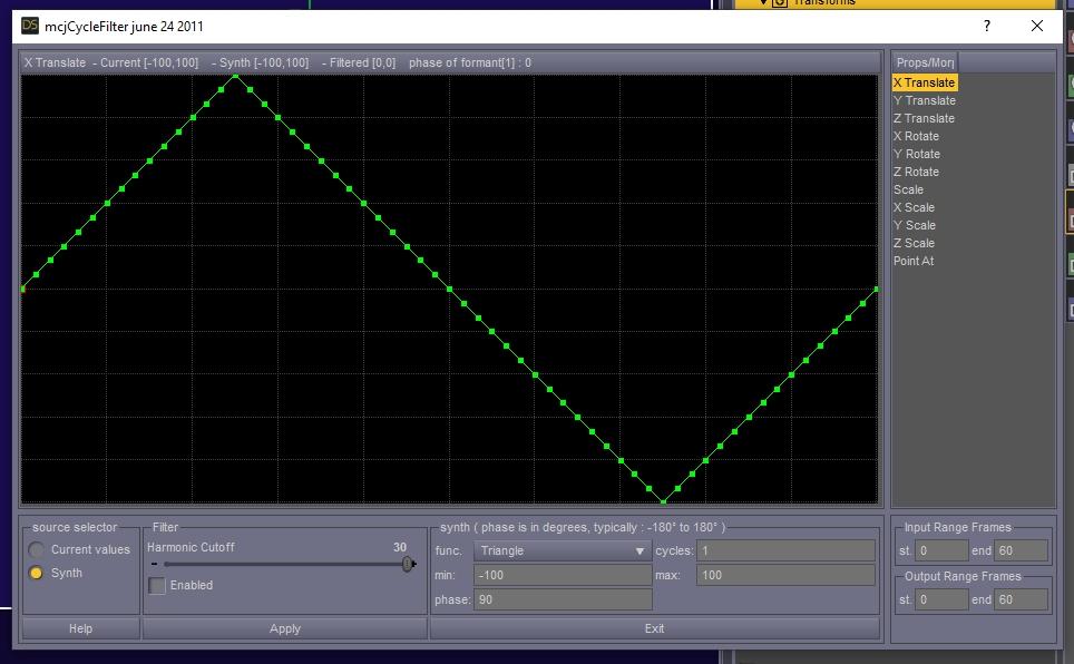

    One suggestion, this tool would be very useful if it also had the option of "delay"(mcjlageffect), in the tab of translators.
    Find another bug, in the mcjCycleFilter.dsa script, which does not delete the keyframes with right click of the mouse.
    To correct this change the line 806
    If (prop.getKeyTime (i) == t)
    To
    If (prop.getKeyTime (i) .valueOf () == t .valueOf ())
    Thanks for your valuable scripts.

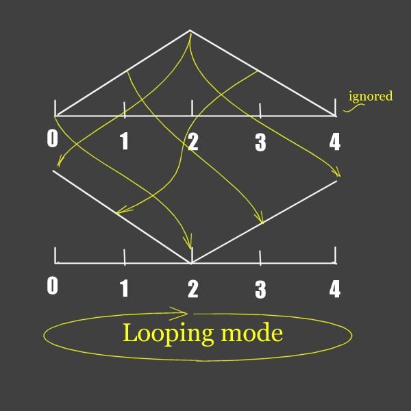

    UPDATE UPDATE UPDATE UPDATE UPDATE UPDATE
    thanks to Armando_CG25 for pointing the bug and suggesting the delay effect
    There's now a Delay option and a Loop/Shift option
    you can use it to make one property animation follow ( or precede ) another property's animation
    600 x 600 - 36K
    800 x 600 - 24K
    edited May 2017
    thanks!
    see the update above or below
