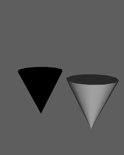

    Actually the easiest way to do it would be to use the free PropViewer...
    http://www.sharecg.com/v/47408/View/11/Poser/PropViewer-3.2
    Simply open the obj in PropViewer, hit Invert and the export as OBJ...
    The cone on the left was scaled -100 % Y-axis, the one on the right 'inverted' (which means 'flip all normals', in PropViewer lingo)...in PropViewer The 'fix normals' option aligns them all the same way...so if they are all pointing 'in', it won't do anything.

  • gioloigioloi Posts: 57
    PropViewer works perfectly! Thanks! :)
