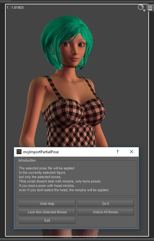

Purpose
You have a full body pose you spent much time perfecting, but you'd like the left arm to be posed just like a pose you purchased.
With this script you can do just that !
________________________________________________________________________
Use
Select the figure bones you want to be influenced by the pose file
launch the script
Click the "Do It" button
Browse up to your pose file and select it
bam it's done !
Behind the scene, the script locked all the bones you did not select,
it unlocked all the bones you did not select
it loaded/applied your pose file
it re-instated the locks/unlocks on all the bones.
Note that this script does not pay attention to the morphs, they dont get locked, so ......
if your pose file contains head morphs ( expressions ) then, even if you did not select the head bone, the morphs will be applied

    UPDATE UPDATE UPDATE UPDATE UPDATE
    There was a small bug wherein the root node didn't get unlocked after the pose was applied
    And i added a button so you can lock the transforms on all non-selected bones
    you are then free to apply poses on the non-locked bones,
    then you can use the Unlock all bones button when you're done
