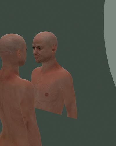

2. The reflections are now extremely angle dependent. A glancing angle, as seen in the posted pic is best. It gives the clearest, sharpest, most 'accurate' reflection. Light angles are now very important as are intensities. Too strong and it will wash out...it seems 'energy conservation' is broken. That would be a 3Delight thing...and needs to be fixed on their end. I tried to get an over the shoulder shot but it would wash out every time, unless I had the light intensity down around 10% or lower.
For the pic, it's Genesis, DzAmbient light (Shader Builder), a cube and a plane. The plane is set to black diffuse, white reflection at 99% and very pale blue refraction set at 1%. The environment mode in HSS is set to 'Raytrace' and the DzAmbient is set to Indirect Diffuse.
I've not been having any problems with reflections. Shown here is a frame from an animation in progress. Note the reflection in the wall mirror.
Here are the settings for the mirror:
Shader: DAZ Studio Default
Diffuse Color: 255,255,255
Diffuse Strength: 0
Glossiness: 100
Specular Color: 255,255,255
Specular Strength: 100
Ambient Color: 0,0,0
Ambient Strength: 0
Opacity: 100
Reflection Color: 255,255,255
Reflection Strength: 100
Lighting Model: Glossy(Plastic)

I've fiddled with it all morning. One thing someone has mentioned to me is that if you have reflection and diffuse = 100 there is less change of blow out. And yes over lighting is an issue. I also got strange things with any specularity if the render is not angled at a flat surface. I may go with separate shaders for flat surfaces and curved surfaces for ease of use.
