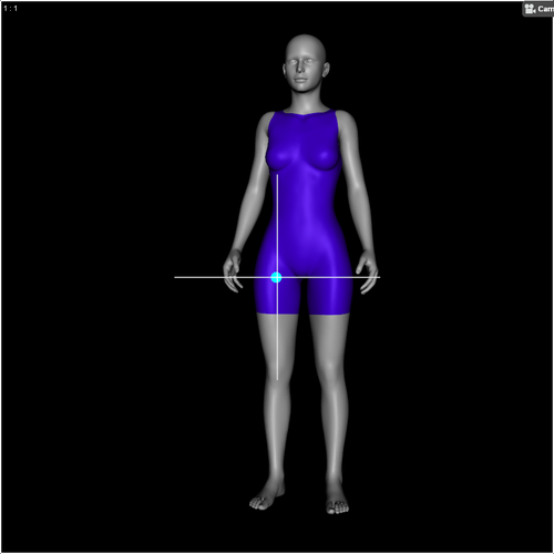

    i used the following code and the setup shown so project a cyan ball onto Genesis
    the second image is the view from the camera in the first image
    node = Scene.getPrimarySelection();
    ball = Scene.findNodeByLabel( "sphere" );
    node.activated();
    processEvents()
    ball.setWSPos( node.getWSPos() );
    node.setLocalPos( DzVec3( 0,0,-10 ) )
    node.getXRotControl().setValue( -90 );
    node.getYRotControl().setValue( 0 );
    node.getZRotControl().setValue( 0 );

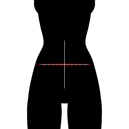

    an mcjCollider parented to a camera rotating around Aiko's waist
    was "fired" 32 times, the UV coordinates of the hit points were then used to create red-dotted texture map
    (which was then reworked a bit in paintshop )
    all this to verify the validity of equations i use to compute those coordinates
    as you can see in the second image
    obtaining this "by hand" would not be a simple matter of drawing points on a straight line
    500 x 500 - 3K

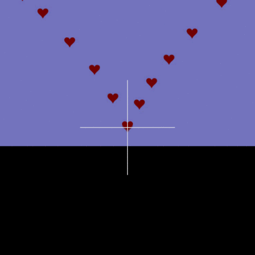

    another test of the new mcjCollider feature: reporting of the UV coordinate of the hit point
    a script, using the services offered by mcjCollider, was used to create a texture map
    and placing heart "stamps" on the texture at the hit-point coordinnates
