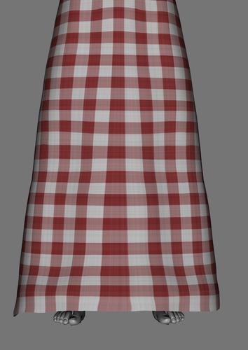

  • BejaymacBejaymac Posts: 2,002
    Pen the attached image shows what happens when you autofit V4's MFD, the hem is all curled up and crumpled, this happens because V4's feet point down, and autofit tries to bend them up to match Genesis, it's field of influence is catching the hem.
    @ Baglet, While you can use ghost bones with WM they really shouldn't be needed, with a single skin mesh you don't have to worry about it splitting from hem to crotch like it does in Poser, you just need to get the WM correct for it to work, and as you can see from the second part of my pic, the WM from autofit is pretty crap, it should be a smooth transition from one leg to the other and not stop dead like it does in the pic.
    @ gilikshe, DS4.5 keeps the morphs when you use autofit or the Transfer Utility, so that link is out of date, and only of use to anyone foolish enough to still be using that buggy alpha called DS4.0.
    950 x 645 - 339K

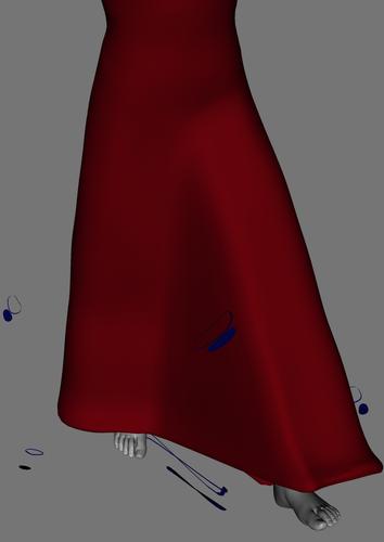

    Thanks for the image Bejaymac...
    Here is my conversion of V4 MFD that took all of 5 mins...
    I added a smoothing modifier
    Changed the smoothing to Generic
    Added some smoothing iterations
    Increased the weight slightly
    Increased Collision Iterations and smoothing interval.
    It's not perfect but it's 5am here still having my first cuppa and only up because I couldn't sleep.
    I'll have a proper look later when I'm more awake. A lot of things that get crumpled with autofit are fixed using the smoothing modifier.
    1000 x 1414 - 198K

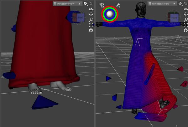

    Pendraia said:
    I have converted a number of things using autofit my main gripe is that there is mesh distortion down the front and back(which I normally fix in Hexagon. If you have Hex it's fairly easy to fix I'm happy to help walk you through the process as best I can...
    I would be so grateful if you showed us how to do that. I have a thread in the Art Studio where I'm playing with autofit and I'm happy for anyone to join in and add info there also...the aim was to see if we could get info on using autofit in one place to make it easier for people to find.
    I will see if I can't get something together. It won't be this weekend, I want to work on a couple of projects I've got going but I will try and write down what I do and post it next time I'm using autofit and hexagon together and post it to that thread.
    Just had a quick play with the left leg forward. The only thing I'm getting is the body handle (blue bit) shows stretching and when turned off it looks alright there is a little bit of distortion around the hem which might need a morph to fix it but I'm not getting that weird distortion on the front that you had. Not sure if that's because I've already used smoothing.
    1000 x 1414 - 202K
    1000 x 1414 - 231K
    It's going to need a bit more than a little smoothing Pen, the hem at the front is meant to sit on the ground, so you need to drop that down about 4 inches, using Dforms or in Hex, the WM for the thigh bones is rough, and there isn't any for the shins, plus the handles are a mess, all in all a lot more work than your average user will want to touch.
    From what I read if you have the Unimesh fits version of the MFD, that's the one with all of the Gen 4 morphs, it was linked to earlier in the thread, then you can reset your downloads and get the Genesis version that way, but if you only have the original V4.0 version then your out of luck.
    However if you happen to have a long dress that's already got proper WM rigging, then you could use that with the Transfer Utility to add that WM to any other long dress/coat, including a reshaped and fixed MFD.
    Have a look here http://www.daz3d.com/forums/discussion/8783/P15/
    I took it in to Hex...the smoothing was a 5 min job, the morph in hex took less than an hour and probably requires a bit more work but shows that it's fairly easy to fix. The hem is easy enough to shift back to the ground...I was just straightening it up to suit what I would use it for. You are probably right that for some it would be too much work though. If you look at the checked version you can see that I really need to play with it just a little more as there is still some distortion.
    I have the genesis mfd but it doesn't have as many morphs as the v4 version iirc...
    1000 x 1414 - 444K
