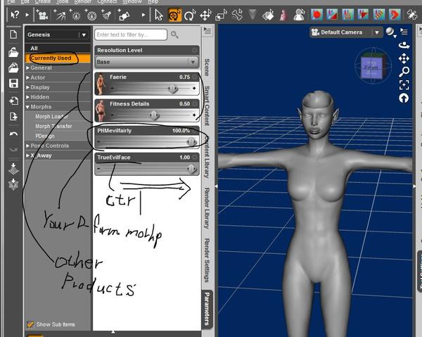

    1, I make new shape by "Farie" 0.75 and adjust shape by "Fitness ditails " 0.5"
    then ,save the shape as character preset. (for safety if I forget the each value,,) as my musclefairy.duf
    if I apply it to zero genesiss , it must move Farie to 0.75 Fitness 0.5 as you know ^^
    2. first check the preset apply it to zero genesis, then I tweak the shape by new D-former from the shape.
    (if apply character preset,, it often difficult which parameter has changed, so it is better discribe
    what controller you moved,, because you can not find them in current used category,,
    it the preset change the value of each morphs,,)

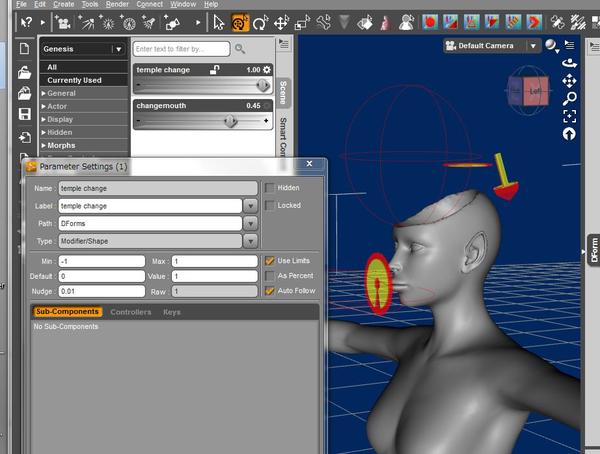

    3 I set two D-former and make each D-former controller by spawn morph.
    then set each parameter range, and defautl value to zero by parameter setting tab (small gear click,,ad you know)
    picture 1
    922 x 697 - 100K

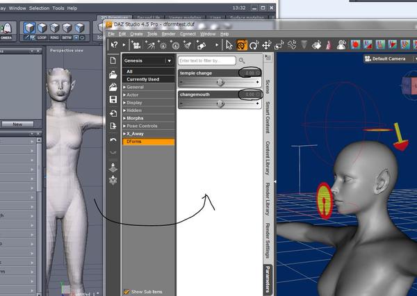

    4a if you need to save each d-former you need to save each D-former as morph.
    it is same when you save your made morph . after save it as morph,
    there is no difference how you made it. tweaking 3d modelor, or made it by D-former,
    now it is just FBM or PBM which have controller to change shape.
    so in this case you make new two PHM for each parts.

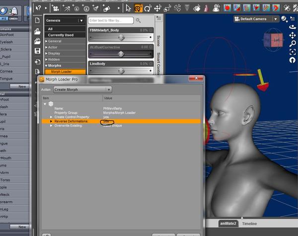

    4b if you want to gather two morphs which you made by D-former, (there seems many way, but if I were you)
    export the current shape (applied each characer morph, and changed by D-formers how you want)
    as obj.
    then in ds 4.5 , turned only D-former values to zero. (it means genesis keep shape which made
    other character morphs)
    import the morph obj which you exported, by morph loader pro,, (I cholse hexagon bridge,, )
    you must need to check on Reverse defomation!!
    978 x 775 - 105K
    1072 x 762 - 115K
  • kitakoredazkitakoredaz Posts: 3,526
    now you have new PHM in moprh loader section.
    but it can change from the character shape you made by other character morphs
    to the evil face you made by D-former. (of coure you can apply this new PHM to zero genesis, but
    it never make "evil fairly shape" ,, if they did not apply the each character falue,,)
    I recommend , save the PHM as morph file on this stage.
    (I do not know how you wanto to set category for this PHM^^;
    so just save it which can find in morph loader pro section.)
    after that I open new scene and apply the saved character preset, then change PHMevilfairly (which I saved)
    zero to 1 for check it. OK it works well.:)

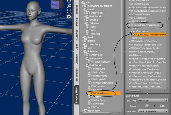

    then select genesis, (if I select genesis first, stop long time,, so I open propertyeditor first,,)
    first I make empty controller to move every morph. on moprh loader category.
    select morph/morphloader section in propertyeditor, then right click > create property.
    then set property for your controller, I set name as ctrlTrueEvilFace,, (not good name I know TT;)
    you need to find the new ctrlTrueEvilFace in left category pane and right Hieralchy pane of property editor.
    1. you need to move Faire 0.75
    the true name is FBMFaire , you drug it from left pane to right Hieralchy section , under the
    ctrlTrueEvilFace sub-componetns section.
    ERC type delta add, sclalar 0.75.
    2 then need to move FitnessDettails 0.5 as you know. (you can easily serch morphs if you apply preset for character morphs,
    which has * marked ,,)
    the true name is FBMFitnessDetails
    drug it from left pane to right Hieralchy section, under the ctrlTrueEvilFace >sub componet
    ERC type delta add, scalar 0.5
    3 I know,, anext you need to move PHMevilfairly you made.
    ERC type delta add. scalar 1.
    4 then move the ctrlTrueEvilFace and check it!
    5 you can check and set it by parameter editor too. (check sub componets what you assigend for the controller)
    6 It is controller but I need to save it as morph I think. so save it as morph.

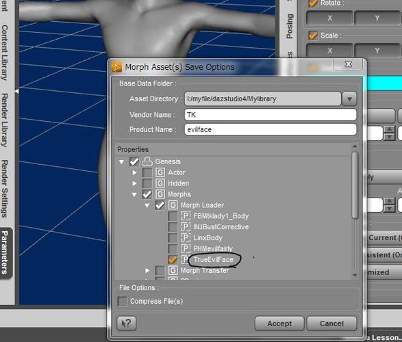

    you just check default value and current value turn to zero. (do not use save modified assets!!)
    and just save the ctrlTrueEvilFace only. at this time. you need not save other morphs .
    you better same product name before you saved the PHM for D-form
    7 after save it, load new scene and load new genesis, check your ctrl, and check currently Used
    and how move moprhs and your figure change shape.
    I hope,, it is what you want@@;

    In kitakoredaz's second screenshot, at the bottom-right note the Save With option. You want that to be set to the controller, not the sub-compoenents as in the image, so that the ERC links get saved in your morph's DSF file.
    Ah,, I know,, so sorry!!
    first I made these morph and save ,check it, then make picture again ><;<br /> so I forgot important thing,,
    yes if do not save "with Controller" , and save With sub-componetn
    it will make ERC code in your FBMfiles ><; forgive me,, please,,</p>
    (but if you do not save these files or, save modified assets, ^^;
    when load genesis , the ctrl can not work. it lost the ERC for each sub conponent..I think,,
    so need to set option save with "controller"
    for each FBM (these are sub componets of new ctrl)
    and save the ctrl only. thanks and sorry @@;

    Okay so I'm home now and ran through the steps for a ERC Freeze of dialed morphs plus spawned DForm morphs... It works just as it should...
    I spawned all the DForms as a single morph, and with other face morphs dialed in I did the ERC Freeze and created a new property. Checked over the morphs listed in the pane and then completed the freeze.
    In the Parameters pane, I selected Currently Used to see only the morphs I dialed plus my morph and controller. I ran the controller back and forth and verified that all the sliders moved. With the controller slider set to full, I dialed down the slider for my DFormer spawned morph to verify that all of the dialed morphs were intact. I also turned off the controller morph, setting all sliders to zero, and dialed in my DFormer morph to verify that it didn't include any of the dialed morphs...
    Then I saved using File > Save As > Support Asset > Morph Asset(s), and checked only my spawned morph and controller morph.
    I then opened the new .dsf files to verify their contents. The spawned morph .dsf listed only 1702 deltas which is about right for my DFormers, and the controller .dsf only listed the formulas for all of the morphs that where used.
    Everything is controlled from a single slider, and using the Property Editor you can locate it which ever group you want.
    You can also now save as a Character preset to dial your slider from the Content Library, or in your case, make Meta-Data for Smart Content... ;-)
    I would also suggest making a list of the morph sets for the morphs that you used. That way if you decide to share it, you can let users know which morphs sets are required to use your morph.
    @kitakoredaz
    Yep, that's how you would do it for imported .obj morphs based on top of dialed morphs...
    If you need anything else....
    nicci... :)
