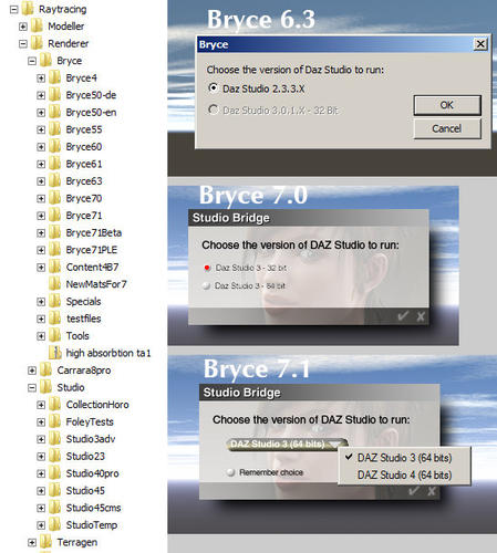

  • HoroHoro Posts: 11,503
    Bryce must be installed first, Studio last. If Studio is already installed, install Bryce and re-install Studio over the existing installation. I have never had to fiddle in the registry. The picture shows that I have several installations of Bryce and Studio and all worked from the first moment.
    Bryce 5.5 launches Studio 2.3 directly.
    Bryce 6.1 launches Studio 2.3 directly.
    Bryce 6.3 asks which Studio I want to launch, 2.3 or 3.
    Bryce 7.0 asks for Studio 3 either 32 or 64 bit.
    Bryce 7.1 asks for Studio 3 or 4 - with 3 it launches 3, with 4 it launches 4.5.
    I don't know why it doesn't work for others the same way.

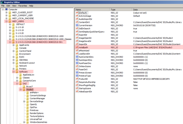

    Here is the thread where Steve first solved the mystery of the registry failures. This thread should jog the memories of both Chohole and Horo.
    http://forumarchive.daz3d.com/viewtopic.php?p=2978930&highlight;=#2978930
    Kerya,
    And just in case you are unable to view the images in the archive I have re-uploaded them with Steve's original instructions. There are two places to make registry edits, both on the DS side and the Bryce side.
    Remember that if any of the keys are missing you will need to create them.
    It seems that creating our own DS3 keys, while effective for the basic function of the bridge, seems to break the function of the drop down that should list which version of DS are available. For me I get nothing on the drop down but because of the registry edits it still starts DS4.5 for me.

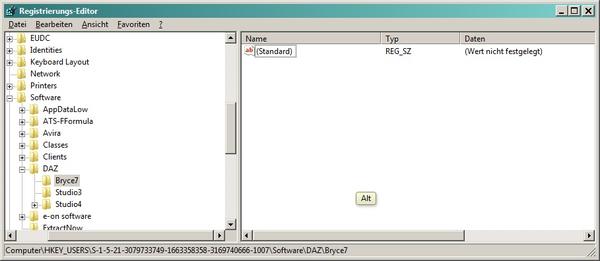

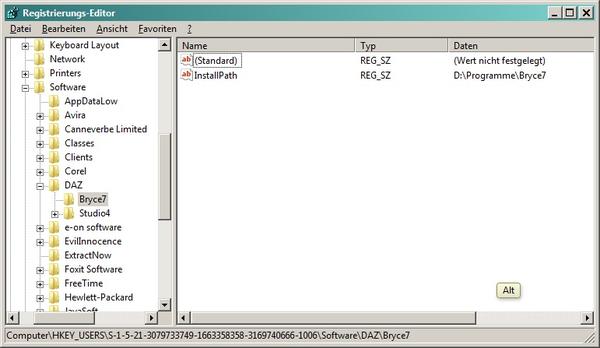

    I poked around a bit more - it seems to have to do with me using a restricted account most of the time.
    I changed to being an administrator and then I DO have those registry keys and all bridges are working.
    Starting regedit as a user, I do get the first picture, as an administrator the second.
    How do I create that line with InstallPath as a user?
    If I rightclick and say new I get a difficult choice of things ...
    Edited to add: funnily as an administrator there is no key for Dazstudio3 ... but it works ...
