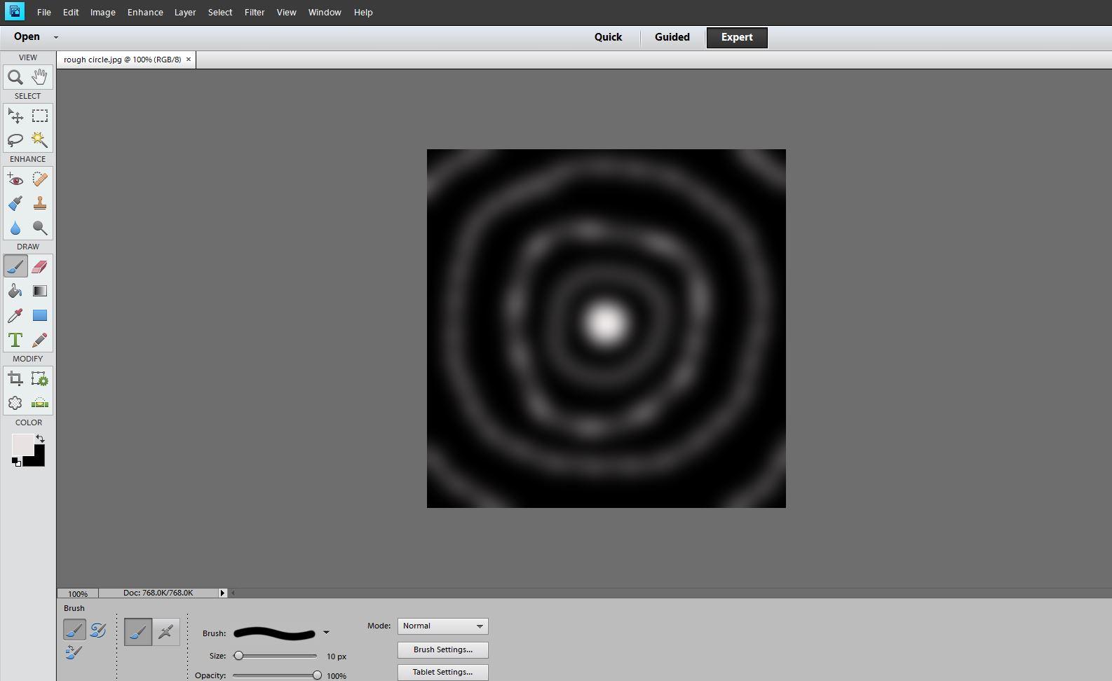

  • DiomedeDiomede Posts: 14,153
    edited January 2017
    RE: wispiness
    As Dart says, you can use postwork and that would be great.
    Within Carrara, you have a number of options, including combining the following:
    1 - shader tree - alpha channel
    2 - shader tree - glow and transparency channels
    3 - object properties - effects tab, blur
    4 - object properties - effects tab, aura

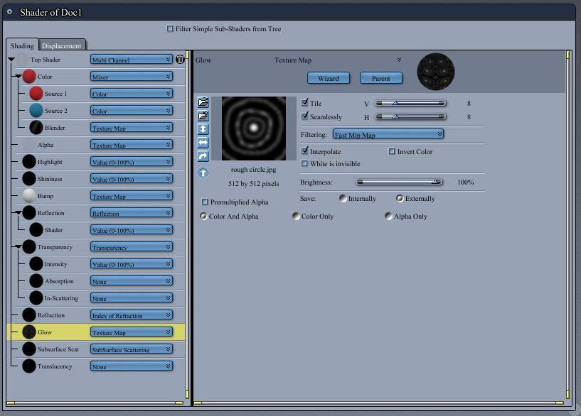

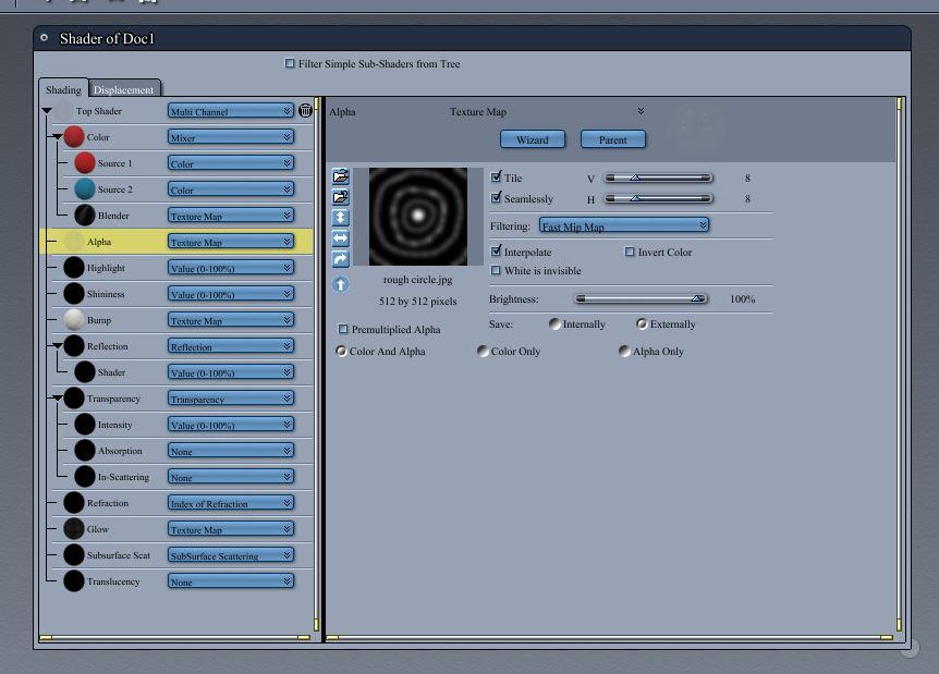

    Here, I've inserted a sphere as a test.  I created a crude circular map in photoshop but I could have rendered out a similar from an image editor.  I used the sphere's shader tree and its effects tab to create a mystic appearance.
    - color channel - I used the tab to set it as a mixer.  I picked two colors, red and blue.  For the blender, I loaded the texture map.  No tiling.
    - alpha channel - I loaded the same texture map but increased the tiling so that it did not match the color channel (broke up the red and blue).
    - glow channel - I copied the alpha channel map and tiling to the low channel.
    I did a test render.

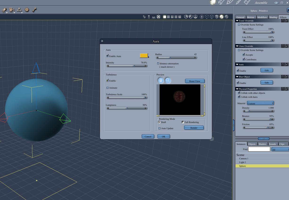

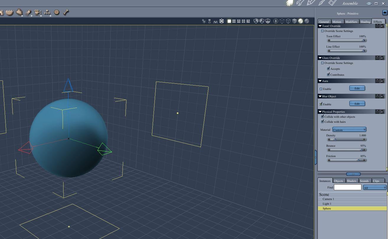

    I then made two more tests with the effects tab in the sphere's property tray.
    - blur - I checked the box to enable blur and then set it relatively low.  This is a post-render effect so don't be alarmed if your scene does not seem to change.  I also tested with a hiher blur setting.
    - aura - I checked the box to enable aura.  I played with the aura color and other settings.  This is another post render effect.
    All of those effects were done just with a primitive sphere and a grayscale map.

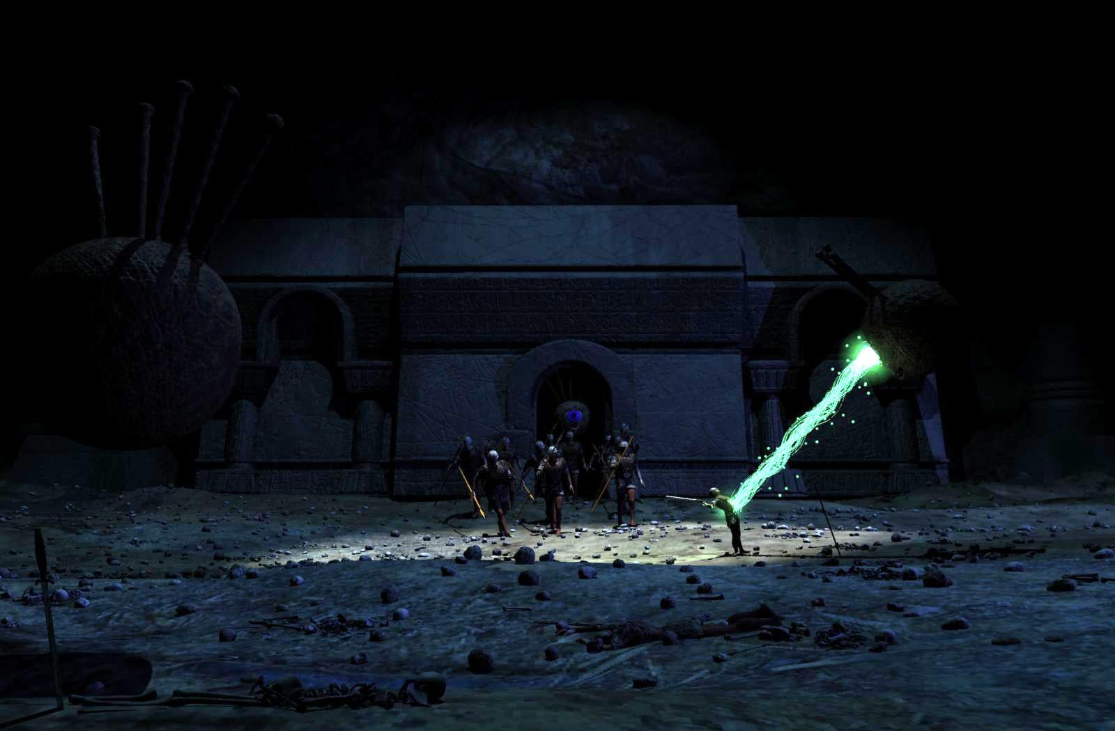

    Very cool thank you! So this is where I am at with this.  I added a texture and fiddled with the blur and glow settings a bit.

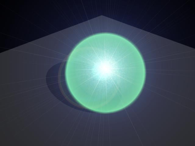

    When going for magical effects, I really recommend playing around with that aura setting that everyone recommends, but another cool trick is to put a light bulb right in the middle of your object/effect.  If you set the Alpha channel on the object to anything but full visibility, you can the use the wide range of effects available for the light bulb (these are all post-render effects so they may not show correctly in a preview) to add even more coolness to your Fx.  Changing the alpha is key to this since the bulb effects only work if Carrara can see the light bulb (it does respect alpha, but not transparency for this purpose IIRC).
    Some examples of stacking effects are attached:
    1. A simple sphere with just a color in the glow channel
    2. The same sphere with the Aura effect added
    3. Same as 2, plus Alpha set to 50%
    4. Same as 3, plus a light bulb in the middle with the Stars and Light Sphere effects on the bulb turned on and a few seconds of playing with the settings
    5. Same as 4, but with the light bulb's Lens Flare turned on and set to the "Blue Flash" preset
    6. The scene showing the light bulb in the middle of the sphere
    Note that I did not use the Blur effect on the sphere at all but got a similar effect by stacking other effects, all of which are applied instantly post-render so my render time is not affected at all.
    Check out my post in the current forum challenge (http://www.daz3d.com/forums/discussion/comment/1981406/#Comment_1981406) to see how I used this to help sell a magical attack in that WIP.

  • DartanbeckDartanbeck Posts: 18,645
    Ooops... I forgot to mention also how much I liked the render - and now it's even better, with the effects on the magical effect objects! Very vice!
    I also wanted to mention that I think it looks right with the spears ends dug into the ground. Makes 'em stick harder when the enemy runs into them!!! :)  Ouch!
    Yeah... very nice job there!
