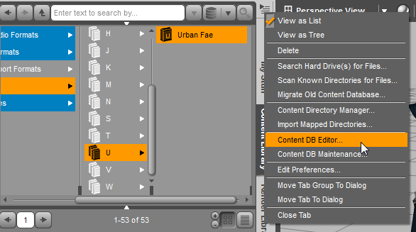

  • edited December 1969
    Just some more of advice I very recently added a new hd,and moved daz over to it
    to give my main drive breathing room.Anyway I rediscover the content db tab you have
    db manager,and maintenance.The tab here should really help you out.Just figured i'd give you a heads up
