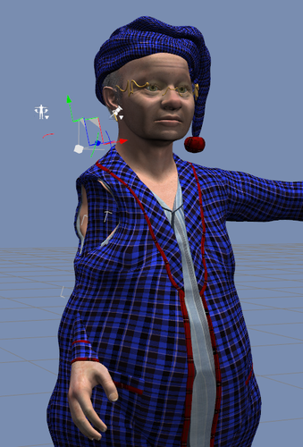

Okay, so here's the thing:
1) I created a character, a pudgy elderly gnome. This involved lots of various different Genesis-based morphs, including DieTrying's free morphs, but most were DAZ's own.
2) I posed the character, did some tests etc. and did regular saving. Couple of times I had to close DAZ Studio due to Windows being up its usual hijinks, such as begging for a reboot or so. Character loaded fine.
3) Today, I noticed the Beautiful Hands package in store, grab it, install it (while DS is closed, note) and then load up my character. Instead of having a charming yawn where I left the character, his right arm is sucked into his body. Okay, maybe something happened? I uninstalled the product, loaded again, same thing happens. I reset the pose, save, try again, and still it keeps happening.
4) I loaded up a plain Genesis, and test what happens when I put the arm a-swinging. Nothing as extreme happens, but something is clearly messed up.
So, um. Does anyone have any recommendations how I should proceed? I'm guessing it might be the freebie morph set that is doing this. But I need those DieTrying's morphs for elderly face and body, but am I able to bake a full-body shape morph out of the knob-twisting I'm done, and just toss the dialed features away and then erase those morphs that are likely messing up things? Or would I still suffer the same fate?

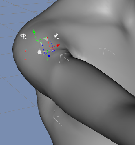

    Okay, I removed the morphs, and I'm still getting bizarro results in base Genesis. o_O I have the original character saved as a Hexagon project, so I can transfer it to DAZ Studio as a full morph, but I'm apparently doing something WRONG because I'm still getting bizarro (even more so than above) results with the morph applied... funny thing is that the facial morphs work just fine, but rotating arms etc is just *broken*.
    So, here's what I did:
    1) Pick right collar, "bend" up to 12.
    2) Pick right shoulder, "bend" up to max (75) and "front-back" to max (75).
    Is anyone else getting "taffy Genesis" out of it? Or is it just me?
    504 x 541 - 70K

    Just did what you did on shoulder and collar. I have the same result so it don't seem to me your base Genesis has any problem. Genesis just isn't perfect

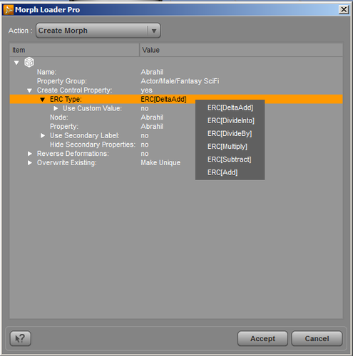

    This is the problem. I have no idea what I'm supposed to pick here and if I need to pick more options somewhere and how to save the final morph with rescaled bones.

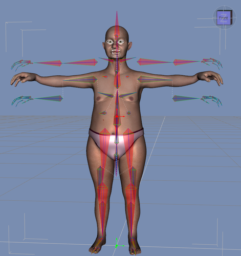

    Okay -- it really seems that the size was the one that futzed the character, so I reinstalled the morphs and went back to original set-up. (Even so, it would be handy to know how to do those permanent character morph thingees in future, so I have to research.)
    I resized my character's joint set up, as told above and tested that the arm more or less rotates the way it is supposed to do (it still has a tendency to vanish into pudgier bits of stomach, but that's stomach's fault at that point).
    I just need to know -- is this how it is supposed to look like after adjusted rigging? With kinda ummm double-boning? Swimming trunks are there for everyone's benefit, as there are things the world isn't ready to see and what's seen cannot be unseen...
    772 x 819 - 251K
  • Richard HaseltineRichard Haseltine Posts: 88,713
    No, that looks very wrong.

  • kitakoredazkitakoredaz Posts: 3,526
    4) picked edit -> adjust rigging to shape
    in many case you can adjust rigging to shape almost.
    but if you change so much shape,(eg child shape)
    it can not adjust good.
    so now your figure joint position (blue color) is far from you want.
    and, you do not have double bone.
    the red one is original (it means before you change the bone rigging)
    and it is not fixed now. (it means you did not save the change rigging)
    so if you memorize> memorize figure rigging , the your rigging is fixed.
    but in this case you should not fix it.
    you need to arrange your bone correctly. then memorize it.

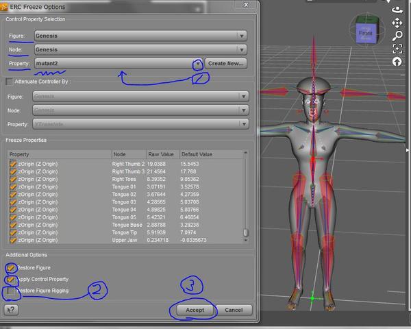

    if you do not mind I want to ask you.
    do you want to make the morph for genesis?
    or if you make morph for another your handmade figure ?
    one of your bones set seems original genesis rigging.
    if you want make morph for genesis,
    and the shape is far from original genesis, (in this case)
    you need erc freeze. to rig move with your morph correctly.
    and in this case you need not memorize> memorize figure rigging
    at all.
    because it change the original rig positon.
    (ofcourse if you do not save the figure, the rigging can not saved)

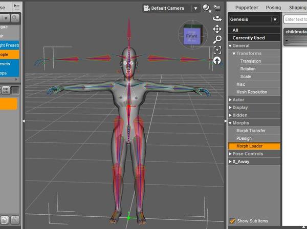

    eg if you want to make morph like eirlian child,
    1. I set morph child and change genesis shape.
    send hexagon by hexagon bridge.
    2 you change the shape or scale as you like
    3 in ds if you hope to change shape from genesis original shape, one controller
    top menu>figure>zero figure. ( or as you like, you just need to reset and keep genesis original shape)
    4 from hexagon use hexagon bridge then export the shape to genesis.
    5 the window open for name the morph, you just set name. (need not tweak option now)
    6 now you have morph controller under parameter tab>morph loader.
    7 set value 100 or 1
    8 open joint editor tab,
    then as you say, try to edit adjust riggin to shape.
    in my case it goes good. check my img
    9 if you feel good, you need erc freeze to save the rigging move with your morph.
    it take more time how to set it with safety... if someone need, i would up.
