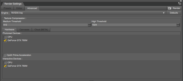

IRAY iMac,
rumpotrumpot Posts: 82
edited May 2015 in Daz Studio Discussion
Testing with SickleYield Iray Starter Scene: from here
Error:
Iray INFO - module:category(IRAY:RENDER): 1.0 IRAY rend info : Initializing local rendering.
WARNING: /src/pluginsource/DzIrayRender/dzneuraymgr.cpp(261): Iray ERROR - module:category(IRAY:RENDER): 1.0 IRAY rend error: CUDA device 0 (GeForce GTX 780M): device kernel image is invalid (Failed to get function attributes)
WARNING: /src/pluginsource/DzIrayRender/dzneuraymgr.cpp(261): Iray ERROR - module:category(IRAY:RENDER): 1.0 IRAY rend error: CUDA device 0 (GeForce GTX 780M): unspecified launch failure (while allocating host mapped memory buffer)
WARNING: /src/pluginsource/DzIrayRender/dzneuraymgr.cpp(261): Iray ERROR - module:category(IRAY:RENDER): 1.0 IRAY rend error: CUDA device 0 (GeForce GTX 780M): device cannot be used as it does not support mapped memory (canMapHostMemory)
WARNING: /src/pluginsource/DzIrayRender/dzneuraymgr.cpp(261): Iray WARNING - module:category(IRAY:RENDER): 1.0 IRAY rend warn : All available GPUs failed.
Iray INFO - module:category(IRAY:RENDER): 1.0 IRAY rend info : Falling back to CPU rendering.
WARNING: /src/pluginsource/DzIrayRender/dzneuraymgr.cpp(261): Iray ERROR - module:category(IRAY:RENDER): 1.0 IRAY rend error: CUDA device 0 (GeForce GTX 780M): Device initialization failed, will not be used
Iray INFO - module:category(IRAY:RENDER): 1.0 IRAY rend info : Rendering with 0 device(s):
Iray INFO - module:category(IRAY:RENDER): 1.0 IRAY rend info : Rendering...
WARNING: /src/pluginsource/DzIrayRender/dzneuraymgr.cpp(261): Iray ERROR - module:category(IRAY:RENDER): 1.0 IRAY rend error: No worker to render with: aborting render
I have a 780M:
VRAM (Total): 4096 MB
Vendor: NVIDIA (0x10de)
Revision ID: 0x00a2
ROM Revision: 3755
OS X 10.9.5 (13F1077)
I have verified with
this
DeviceQuery:
/deviceQuery ; exit;
/Developer/NVIDIA/CUDA-7.0/samples/bin/x86_64/darwin/release/deviceQuery Starting...
CUDA Device Query (Runtime API) version (CUDART static linking)
Detected 1 CUDA Capable device(s)
Device 0: "GeForce GTX 780M"
CUDA Driver Version / Runtime Version 7.0 / 7.0
CUDA Capability Major/Minor version number: 3.0
Total amount of global memory: 4096 MBytes (4294508544 bytes)
( 8) Multiprocessors, (192) CUDA Cores/MP: 1536 CUDA Cores
GPU Max Clock rate: 784 MHz (0.78 GHz)
Memory Clock rate: 2500 Mhz
Memory Bus Width: 256-bit
L2 Cache Size: 524288 bytes
Maximum Texture Dimension Size (x,y,z) 1D=(65536), 2D=(65536, 65536), 3D=(4096, 4096, 4096)
Maximum Layered 1D Texture Size, (num) layers 1D=(16384), 2048 layers
Maximum Layered 2D Texture Size, (num) layers 2D=(16384, 16384), 2048 layers
Total amount of constant memory: 65536 bytes
Total amount of shared memory per block: 49152 bytes
Total number of registers available per block: 65536
Warp size: 32
Maximum number of threads per multiprocessor: 2048
Maximum number of threads per block: 1024
Max dimension size of a thread block (x,y,z): (1024, 1024, 64)
Max dimension size of a grid size (x,y,z): (2147483647, 65535, 65535)
Maximum memory pitch: 2147483647 bytes
Texture alignment: 512 bytes
Concurrent copy and kernel execution: Yes with 2 copy engine(s)
Run time limit on kernels: Yes
Integrated GPU sharing Host Memory: No
Support host page-locked memory mapping: Yes
Alignment requirement for Surfaces: Yes
Device has ECC support: Disabled
Device supports Unified Addressing (UVA): Yes
Device PCI Domain ID / Bus ID / location ID: 0 / 1 / 0
Compute Mode:
< Default (multiple host threads can use ::cudaSetDevice() with device simultaneously) >
deviceQuery, CUDA Driver = CUDART, CUDA Driver Version = 7.0, CUDA Runtime Version = 7.0, NumDevs = 1, Device0 = GeForce GTX 780M
Result = PASS
logout
[Process completed]
bandwidthTest:
[CUDA Bandwidth Test] - Starting...
Running on...
Device 0: GeForce GTX 780M
Quick Mode
Host to Device Bandwidth, 1 Device(s)
PINNED Memory Transfers
Transfer Size (Bytes) Bandwidth(MB/s)
33554432 3175.9
Device to Host Bandwidth, 1 Device(s)
33554432 6125.9
Device to Device Bandwidth, 1 Device(s)
33554432 33569.2
Result = PASS
NOTE: The CUDA Samples are not meant for performance measurements. Results may vary when GPU Boost is enabled.
logout
[Process completed]
Daz 4_8_0_51
I have selected GPU only, but it only uses CPU
1310 x 311 - 202K
917 x 406 - 40K
Post edited by rumpot on

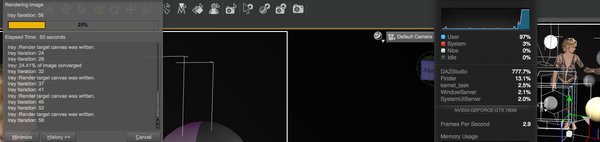

  • nemesis10nemesis10 Posts: 2,251
    I have a somewhat similar setup as yours (iMac with the same graphics card) and am not seeing this problem. In general, I am finding i can render faster in iRay than I can in the standard renderer. Is it possible that you have a defective card? This is a recent render I did.
    1638 x 1109 - 356K

    I have toggled this:
    But I still get a lot of this
    Iray INFO - module:category(IRAY:RENDER): 1.0 IRAY rend info : Using batch scheduling, architectural sampler disabled, caustic sampler disabled
    Iray INFO - module:category(IRAY:RENDER): 1.0 IRAY rend info : Rendering with 1 device(s):
    Iray INFO - module:category(IRAY:RENDER): 1.0 IRAY rend info : CUDA device 0 (GeForce GTX 780M)
    Iray INFO - module:category(IRAY:RENDER): 1.2 IRAY rend info : CUDA device 0 (GeForce GTX 780M): Scene processed in 14.905s
    Iray INFO - module:category(IRAY:RENDER): 1.2 IRAY rend info : CUDA device 0 (GeForce GTX 780M): Allocated 5 MB for frame buffer
    WARNING: /src/pluginsource/DzIrayRender/dzneuraymgr.cpp(261): Iray ERROR - module:category(IRAY:RENDER): 1.3 IRAY rend error: CUDA device 0 (GeForce GTX 780M): unspecified launch failure (while launching CUDA renderer)
    WARNING: /src/pluginsource/DzIrayRender/dzneuraymgr.cpp(261): Iray ERROR - module:category(IRAY:RENDER): 1.3 IRAY rend error: CUDA device 0 (GeForce GTX 780M): Failed to launch renderer
    WARNING: /src/pluginsource/DzIrayRender/dzneuraymgr.cpp(261): Iray ERROR - module:category(IRAY:RENDER): 1.2 IRAY rend error: CUDA device 0 (GeForce GTX 780M): Device failed while rendering
    WARNING: /src/pluginsource/DzIrayRender/dzneuraymgr.cpp(261): Iray ERROR - module:category(IRAY:RENDER): 1.2 IRAY rend error: CUDA device 0 (GeForce GTX 780M): unspecified launch failure (while initializing memory buffer)
    WARNING: /src/pluginsource/DzIrayRender/dzneuraymgr.cpp(261): Iray ERROR - module:category(IRAY:RENDER): 1.2 IRAY rend error: All workers failed: aborting render
    WARNING: /src/pluginsource/DzIrayRender/dzneuraymgr.cpp(261): Iray ERROR - module:category(IRAY:RENDER): 1.2 IRAY rend error: CUDA device 0 (GeForce GTX 780M): unspecified launch failure (while de-allocating memory)
    WARNING: /src/pluginsource/DzIrayRender/dzneuraymgr.cpp(261): Iray ERROR - module:category(IRAY:RENDER): 1.2 IRAY rend error: CUDA device 0 (GeForce .

    Tried again in DAZ and still get WARNING: /src/pluginsource/DzIrayRender/dzneuraymgr.cpp(261): Iray ERROR - module:category(IRAY:RENDER): 1.3 IRAY rend error: CUDA device 0 (GeForce GTX 780M): unspecified launch failure (while launching CUDA renderer)
  • recharredrecharred Posts: 16
    Did you ever resolve this? If not, did you try the nvidia web drivers?
    http://www.nvidia.com/download/driverResults.aspx/103826/en-us
    I'm curious whether iray acceleration works with the native mac drivers at all. Can anyone confirm? If so, can someone test the case described here:
    http://www.daz3d.com/forums/discussion/97496/mac-gpu-acceleration-crashes-and-workaround#latest
    Thanks!
