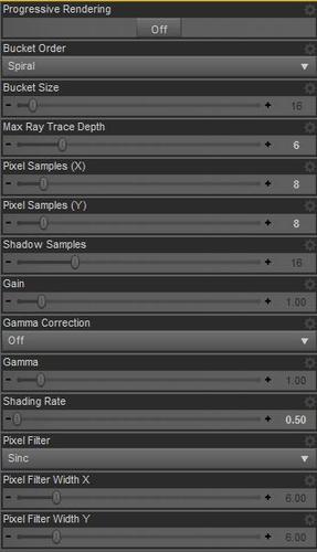

    OK, just ran some new tests in 4.7. If you don't have them in a scene, there is no light/reflections to pick up and they can look grey. I put these in A Curious Gazebo, just because it was handy and used one of BWC Sedor's skydomes. I have attached both the render and the settings I have used in 3DL.
    Let me know if that fixes it.

    You can most likely drop your ray trace back to at least 8 if not 6. You might try setting the shading rate to 0.1 or 0.2 to help with the grain. It will increase render times, but hey, you have to sleep sometime. :)
