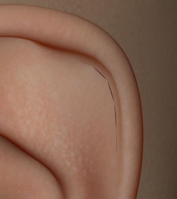

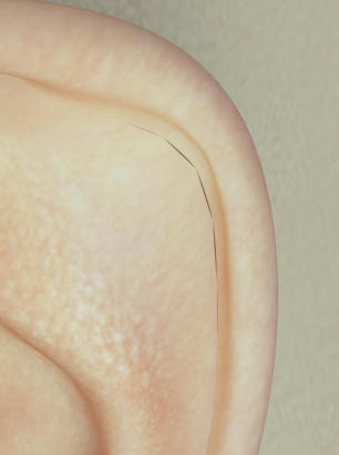

Ok- this is weird.
The crack in both ears is there no matter what I do. I've taken off the displacement to see if it was that. It was still there. I switched and took off the bump completely and left the displacement on, it was still there. I took both the bump and displacement off of M4, and it's STILL there.
I rendered it with one infinite light, no IDL, it's still there (the other renders were all IDL).
First render is no bump/displacement in IDL.
Second is no bump/displacement with no IDL, just the one infinite light.
What the hell?

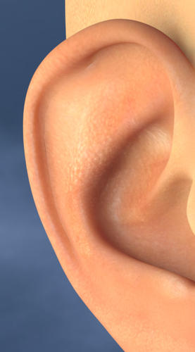

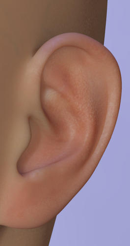

    I started a new scene, with a new M4 and did the process of injecting the morph sets, the dialed morph, the texture set and rendered again (IDL again). They aren't so obvious, but the cracking of his ears is still there. I'm not sure what the heck is wrong, but it's really frustrating to me since I've not had this issue before in making M4 characters using any light rig up until now.

    I'm not at my Poser machine, but i think you are seeing a uv seam. Try setting the texture filtering to Crisp for the head material. (this can easily be done globally with Snarlygribley's Scenefixer, if you have it).....
  • DarwinsMishapDarwinsMishap Posts: 4,087
    It is a seam, I've gone in and worked the maps at the seams many times. I will change them to crisp on each (bump, displacement and diffuse) and see if that helps. Thanks!

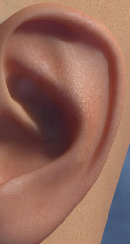

    Found out it was not a seam that cause the break. The mesh itself has an issue at that spot on both ears. The base, un-textured and unmorphed M4 has it as well. I did use the morph brush in Poser 10 to smooth the issue out and made a dial in his head parameters to fix this issue.
    394 x 742 - 104K
  • WandWWandW Posts: 2,882
    I'm glad you got it straightened out. I tried it, and the issue seems to be related to the smoothing; setting the crease angle for the head to 150 got rid of it for me...
