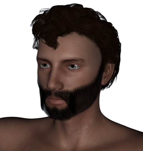

    Most short hair products are props so can not be autofitted to G2M, assuming you have the M3 and M4 shapes for G2M. However you can easily get them to fit, particularly if they have the clone shapes. For M4 hair props you do the following:
    1) Load G2M
    2) Morph G2M into the M4 shape.
    3) Load the M4 hair prop and parent it to G2M's head
    4) Remove the M4 morph, and then change G2M into any shape you need, the hair should scale to match. This worked in most shapes I changed to, but some extreme ones like A3's head did not work.
    I have attached a pic showing G2M base shape with K-Nicky hair for M4 (fitted using above method), and M3 Long Beard, short beard option (Fitted using auto fit with the M3 shape).
    834 x 882 - 611K

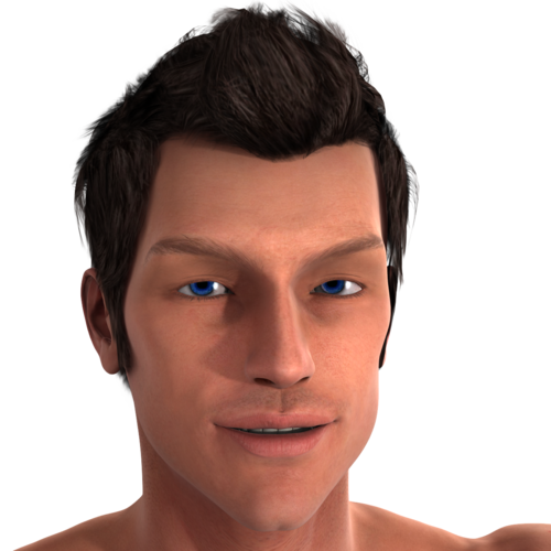

    Daryl Hair fis to G2M automatically. BillyHawk does not.
    Below you will see BillyHawk on G2M/M6.As a short hair, it works fine because it doesn't change the rigging in the long bits to conform weird to the movement. Here is what I did to make it work without having to refit it every time in Daz 4.6.
    1) Load in G2M with no morphs.
    2) Load in BillyHawk without conforming it to G2M (parent it to the head though--this should be the default double click behavior).
    3) Use the translates and scales to get it where you like it.
    (my settings were yTran 11.14; zTran 1.22; Scale 107.2%; xScale 97.6% on the base BillyHawk, not the BillyHawk_M4)
    4) Select it in the scene tab then go to File > Save as > Support Asset > Figure/Prop Assets
    5) Give it a name and hit Save.
    6) Fill in the names and categories if you want to make it easier to find.
    7) Hit Accept
    You should have a figure/prop that will load to G2M. For some reason transfer utility isn't working on it and wipes the style morphs. I'm sure there's a more elegant way to do this, but that's all I got for ya now.
    1200 x 1200 - 1M

    The style morphs aren't wiped. They just become hidden and are there somewhere. Just go through the hair morph directories. I'm pretty sure you will find them there somewhere.
    Post edited by Zev0 on
    Search for a folder called "auto-adapted". I find all items I autofit there.
