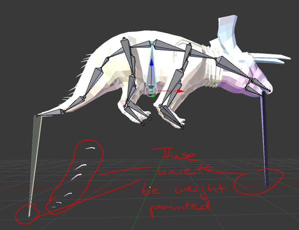

Trip had 2 issues:
=> location and rotation were not applied. Not only scale, but also location and rotation should be 0/0/0 (scale at 1/1/1 each).
To fix this:
- select the mesh
- hit ctrl+A and pick location
- hit ctrl+A again and pick rotation and scale
I have attached a screenshot.
=> The mesh had some vertices with no weight assigned (moving the root around showed some parts of the mesh left behind)
To fix this:
- weight paint the parts left behind
result imports fine into Carrara

Yes, you can rig and animate your characters in Blender and export them as FBX to Carrara.
But there might be some features that do not translate over.
B-Bones for example do not seem to work.
I also wasn't able to get shape keys from Blender to Carrara, but maybe someone else found a solution for this?
Anyway if you will make the step to rig and animate your characters in Blender it possibly will be easier to just render it in Blender too.

I haven't been able to get any FBX with intact rig from Carrara to Blender,
neither Poser rigs nor Carrara rigs
Possibly someone else found a way?
MDD works fine, but since DAZ/ Poser content has a huge poly count the MDD files become very big.
not Daz or any other imported fbx rig
but I have gotten things in I rigged and animated myself
and some things by others like Andy's Kreature, via collada.
