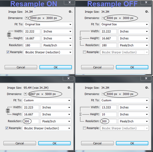

    One thing to watch out for when modifying the DPI in an image editing application is whether resampling is on or off when you type in the new DPI. My examples below are from Photoshop, so it may appear different in other applications.
    If resample image is ON, and you enter a new DPI (Pixels/Inch), the number of pixels in the image will change, which may not be what you want depending how you are going to use the resulting image.
