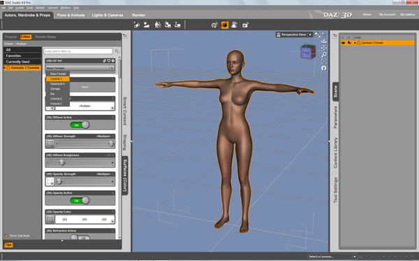

  • 3DAGE3DAGE Posts: 3,311
    HI Antara :)
    The answer to all your questions is inside DS
    Load a Figure,. then go to the Shading tab, and see what UV sets you have available for that figure. (see pic)
    You can select the UV set you want,. Add the textures you want,.. then save that as a DUF file and load it into Carrara,
    Or,..
    take a mental note of what figure you had, what UV set it used, and what textures you want to apply,... and load all of that in carrara.
    Thanks Antara :)
    Interesting work-flow.
    I'd think that M5 will map best with it's own texture sets, since they are created using the M5 Uv's
    It can handle UV's from other figures, but the UV's or textures you use, depends on the figure you load to work with.
    If you load Genesis male base, (in DS) and look at the Surfaces tab,.. it's default UV is M4
    If you load the Michael 5,. then it's Default UV is M5
    if you wanted to work with M5, but use M4 texture maps to make your own character, then you can change the UV's in DS, and save that (new figure) to the library.
    By loading the figure you want to work with in DS, and going to the surfaces tab, you can quickly see what's available, and change it's Uv's to suit the textures you want to work with.

    For the images you can edit in PhotoShop, go to your DAZ Library folder
    Open Runtime > Textures
    The DAZ figures originals are under DAZ > Characters
  • DartanbeckDartanbeck Posts: 18,108
