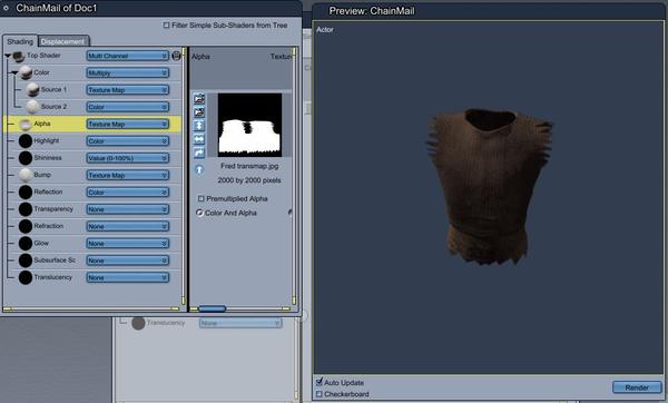

I have an item of clothing and I have made a transmap for it to give it a jagged look.. see the images
I want to add fur to the clothing which is an easy part, but how do I apply the fur to only the part that is visible and not the transmapped parts?
I can't find anywhere to add a map for the clothing fur....
thanks anyone

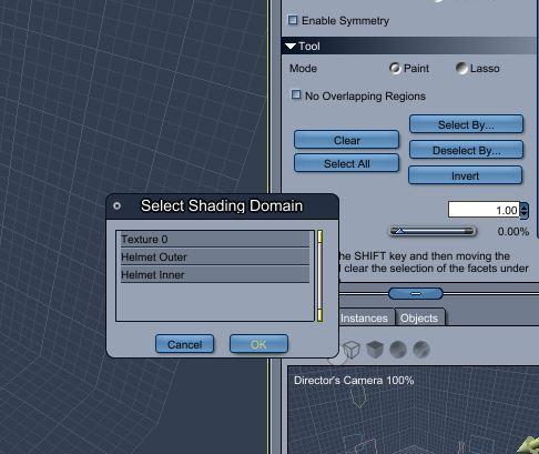

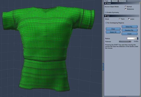

  • DiomedeDiomede Posts: 12,684
    Couple of options might work
    in the hair domains tool, use select by
    1) you can create a shading domain where you want the fur
    2) you can load a texture map (uv based) for the distribution of fur
    3) you can use the green paint tool to paint where you want the fur
    Holly has a fur tutorial if we can track it down. My guess would be that it is at carraracafe.
    On second thought, you are probably going to do what you want to do in the hair shader room. Use a similar texture map for the density in the shader that matches your alpha setting.
    277 x 395 - 33K
  • StezzaStezza Posts: 6,559
    Thanks diomede64,
    that option solved my problem... :-)
