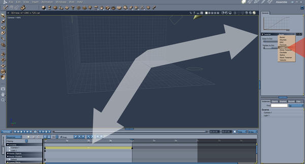

    Yeah... it's the bezier tweener on the camera track that's making your view get all funky. Open the Sequencer along the bottom, select the space between the keyframes for the camera in question, and look to the right panel. Under tweener type, change the drop-down selection to linear and you'll have it. ;)
    Hey Dart, it sounds to me from the description that it's not the bezier tweener. It would be the same issue with the Linear tweener. The issue is the shortest distance between two points is a straight line. Carrara is moving the camera in the most efficient method between the four key frames.
    Both Andy's and Andrew's methods- move camera hotpoint or parent camera to target helper object and then the spin modifier for both options would be the fastest and smoothest way to go.
    I see...
    Must have gone insane for a second there... sorry about that :ahhh:

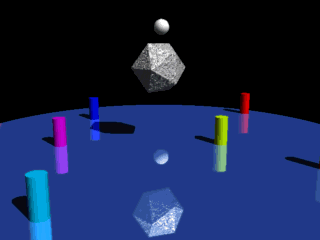

    Hi, following the mini tutorial by 3DAGE, I made this little movie. I added items to show various objects in space, as mentioned in the tutorial the camera follows the spin rotation of the target helper object (positioned in the middle of the scene, just below the icosahedron).
    I know, it's a small thing, but I'm like a sponge: I follow constantly almost all posts, learn, I understand (or not :P ), do experiments, I try and try again. :cheese: and I would like to thank to all of this fabulous community for the great work.
    Ciao, Max.
