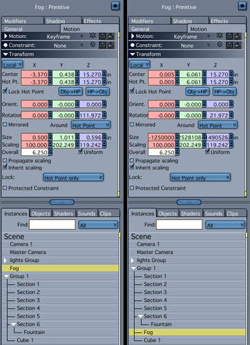

I created a fog object and scaled it properly. When I group that object with another (dragging child over parent), it disappears and its size changes to -1000000 or some absurd number.
Has anyone experienced this problem and, more importantly, found a workaround?

    I forgot to add that the group has a Bend&Twist; modifier. I created a test file to replicate the problem and it only appeared when I applied the modifier.
    I attached the test file. Just drag the Fog object in the Group. [update: forum won't let me upload a Carrara file]

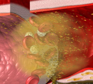

    I added a little cloud effect. Which works fine. It's only when I tried to attach it to the object that it got destroyed because the group had a bend & twist modifier attached to it. I ended up keeping the 2 separate, which was fine since I only rendered a still image. I suppose I could have used a track modifier if I wanted to do an animation.
    This got me thinking that it would be very nice to be able to create a cloud as a vertex object. You would model it in the VM, but when it's rendered, the faces are hidden and the volume is filled with smoke or vapor. Of course with settings for density, falloff, turbulence, etc.

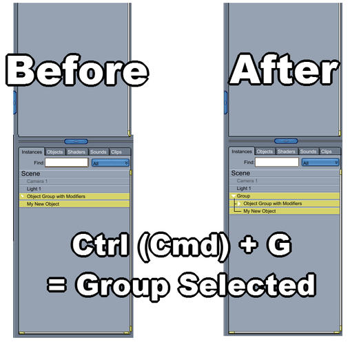

    This got me thinking that it would be very nice to be able to create a cloud as a vertex object. You would model it in the VM, but when it's rendered, the faces are hidden and the volume is filled with smoke or vapor. Of course with settings for density, falloff, turbulence, etc.To put both of them in a group, without getting the modifier added to the other, select both items from the list and Ctrl G (Group) them. If the model with the modifier is already in a group... that's not anything to worry about. It can be in both.
    So you'll end up with:
    New Group Contains
    Object group with modifier attached
    plus
    Other object
    plus
    Anything else you want to put in this group
